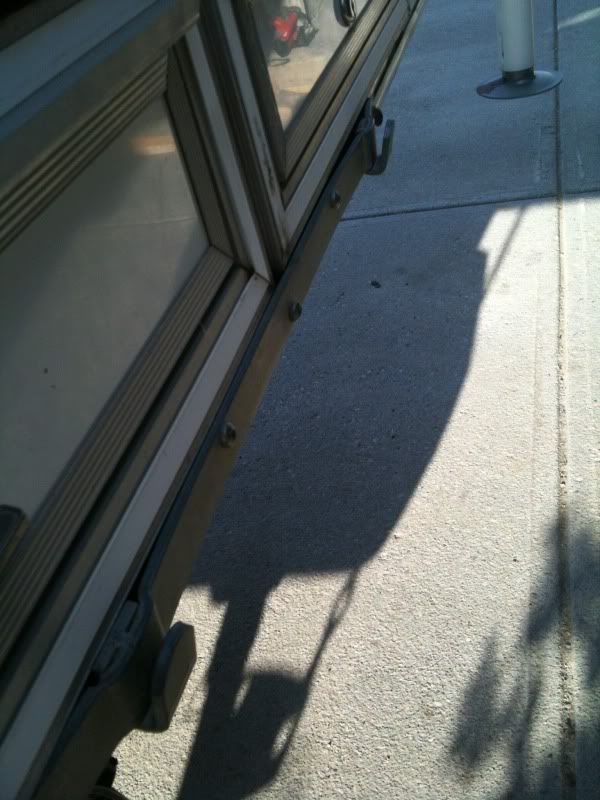

Here's the pics, as you can see it has a bracket already mounted that has hooks on it. I think I can build a bracket to drop into the hooks, just not sure what's supposed to keep it there other than gravity.

I have the same bracket, I do not know how to do to fix the step. I thougth drill to holes and screw the step, but need to fix bottom when drive, not sur how to fix it and keep an easy deployment.

That flat hook setup is what I used to have any it really annoyed be. It always seemed like the step was uneven and about to pop out of one side. Not to mention I had to put the steps inside for transportation. I bought some glow steps and I sure like them. The bracket they use has pins and will not come loose. You can also install some locks in place of the pins.
