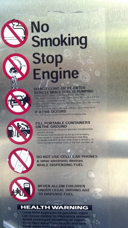

Here are the warnings at the Gas Station I got gas at this morning. I will admit that whoever wrote these is an idiot. A 'fridge in an RV is more of a danger than a cell phone!
And

I did not think there was any thing about shutting off the generator and I see this supports that is correct.

There's nothing about using an acetylene torch or lighting a campfire either.

Would that be covered under "STOP ENGINE"?
