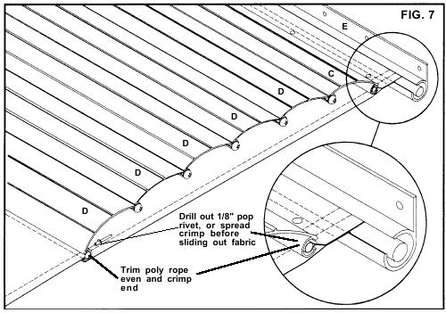

Posted: 03/23/05 01:30pm Link  |  Print  |  Notify Moderator
I know it is hard to explain what all they did on the awning. Let me try here: the metal cover is in kind of 'slats'. Ours, the 9000 model, was a 6-slat. On the original one the fabric fit in a special rod at the end of the slats so when it rolled up the fabric was completely covered. The instructions for replacement fabric tell them to remove the rod, which was hooked to what they called Slat "A", that held the original fabric and one slat (Slat "E", which is the one closest to the motorhome. Then the fabric is installed up underneath the remaining slats, attached underneath to the motorhome and again to the edge of Slat "A".
For 6 slat models, the instructions do say to remove one slat- but then you replace it- when done it should look like this-
with the new fabric held at both the top and bottom.
This is from my 2005 manuals.

Chris. We had ours replaced. A&E 8500. Looks the same when finnised as the picture you posted. Awning is tight.
