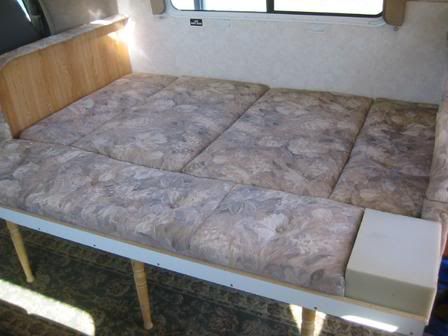

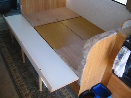

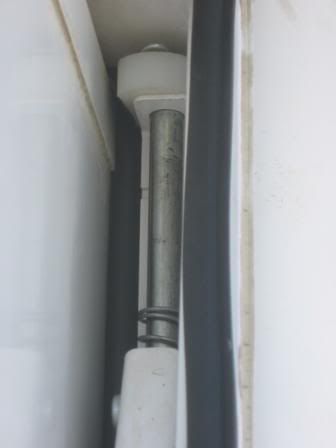

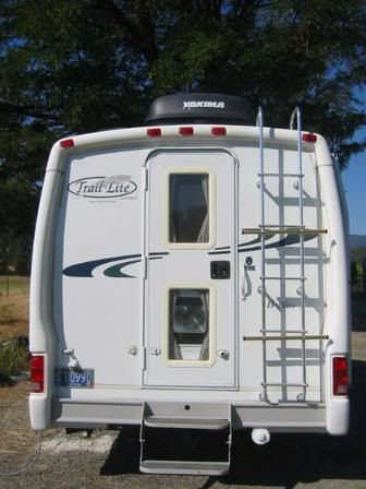

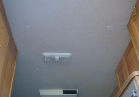

Here they are, hope Gary does not mind....

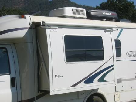

The above shows the awning over the slide.
The above shows the bed extension he added.
I believe he was showing the extra seal he added for water proofing the slide.

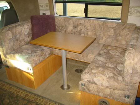

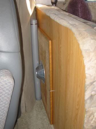

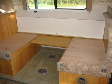

The above shows where the table top and pedestal are stored.

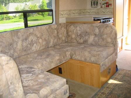

The above shows the remodeled dining area seating.
The above shows where the bed extension is stored.

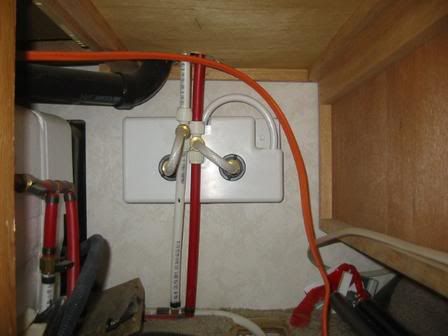

The above shows some changes to the plumbing - I don't remember what was changed.

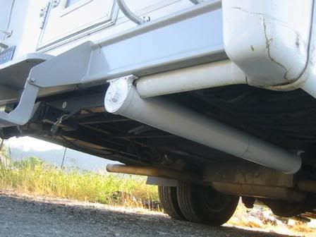

The above shows the storage tube for the longer sewage hose.
The above picture without the table in the dinette.
The above shows the change made to quiet down the rattle of the slide.

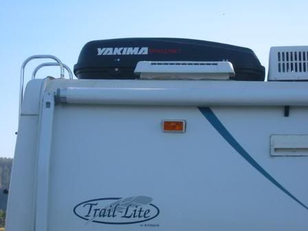

The above shows the Yakima box on the roof and the sewage hose additions.
The above shows another picture of the Yakima box.
The above shows the hardware used for the bed extension attachment to the dinette.
The above shows the bolts coming through the ceiling with washers to hold the Yakima box.
The above shows the cushions laid out for sleeping.
Was going to share the entire folder, but could not make it work. So...needed to do individual pictures.
Added descriptions to the pictures.*

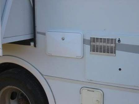

Thanks Gene, interesting mods. Has any topic contributor made a change in the size of the battery access door on a 213 or other model Trail-lite that you remember?

Haven't made it through all of the posts in this thread yet ... with my 40 posts per page I'm on page 68. I do have a question though. Has any one posted on enlarging the "battery hatch" opening when adding a second battery to the Trail Lite 213, ours is a 2004.
