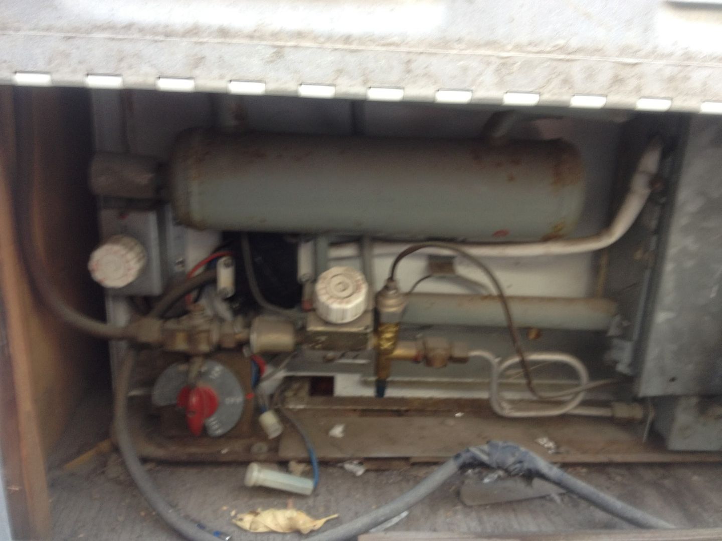

here a couple pic from the back
first pic can see a plug listed as 12v
i could not for the light of me find 12v power coming in and going to the junction box . well none at rear of fridge .
i did how ever find i hole which looks like an old location for wires coming in .
as well you can see some one has hacked the 120v supply .

Well first there is a blue wire laying on the bottom of the compartment. That is a fuse holder and it needs a fuse in it or nothing is going to happen. Second you should probably verify that the fuse holder is receiving 12 volts DC.

I think the 12 volt "white plug" is really a terminal block, look for screw heads at the bottom of the round holes in the white block. The screws need to be snug, not too tight the plastic block could break or strip out.

And opnspaces that picture is like from a week ago ,
And fyi you dont need a fuse in it to test for power your hot side will have power regardless if there is a fuse in it or not .
