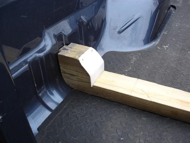

I have to add two inches in the bed of my truck so the camper clears the cab of the truck and I like the guides I have seen here at RV.net.
So I made these out of 4 X 6 timber, I still need to round over the sharp edges and add UHMW plastic to the angeled slope to reduce friction. I also put 2" pink foam board in front of the front guide and in between the guides and a piece behind the rear guide, the camper is mainly supported by the foam not the guides.
The ends are cut with tenons sticking out that slide into the ribs in the factory bed so they don't move at all. The straps in the photo are just the way I store them, they are not holding the guides at all.
Edit 3/24/06 to add photo with foam board.
I have since used silicone caulk and glued the foam to the bottom of the camper so now theres one less step in getting ready to load or unload.

Spott
SE Michigan
Joined: 12/03/2003
Posted: 02/07/06 03:15pm Link  |  Print  |  Notify Moderator
Here's the UHMW plastic added to the guides.
