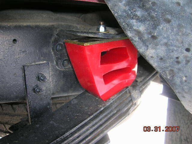

For you guys that haven’t heard of this or haven’t yet did it I thought I would share a little project that I just completed. My truck is lifted a little so the overloads never touch the perches no matter what I load up but even in stock form the perches are up a little high. After searching on this site about what to do about this I found that at energysuspension.com you can find a variety of bump stops that are intended to go between the axle and frame but they work great to go between the spring and perch. I ordered a set of 9.9109 low profile stops and a set of 9.9104 high stops from Schucks auto parts. Due to my lift the rear perches are farther than the front so I needed the two different sizes.
Here are the pictures of the install: Please pardon the dirt, mud and grime-today is the first day we have had over freezing since last fall. Spring cleaning will begin just as soon as water will flow through my garden hose.
Stock front:
Stock rear:
Modified front:
Modified rear:
Loaded front:
Loaded rear:
Loaded front with 50 psi in the air bags:
Loaded rear with 50 psi in the air bags:
With the extensions in place the load is much more stable and the overloads are actually doing something. If you check out the Energy suspension link above you will find bump stops in all shapes and sizes to suit your needs. Some of the guys here go with the 9.9109 low profile stops while some go with the 9.9121 Low profile button head bump stop. If you are going to pack a camper you might check into extending yours so that the overloads actually do something.

Crumm thanks for the post. This is what I need to give my overloads some work and possibly prevent my air lifts from breaking bolts in the future. Ed

I ended up doing something very simmilar to my Dodge 2 years ago. I installed 2 1/2" bumpstops to the overload spring perches, and now they're now fully engauged when the camper is on. This helped out quite a bit with the handling.
On every truck Ive owned with overloads,(both Ford and Dodge), theres been such a large gap between the springs and the perches that it basicly renders them useless. Why they design them this way is a mystery to me.
At least the longer stops are a fairly cheap fix for the problem.

the only thing i did different was to 'trim ' down the bump stops . i just cut off the 'tapered ' part on the bottom , that way they weren't compressed .

what gets me is my truck loaded is slightly over loaded, i think? about 3 to 5 hundred lbs over, i guess. and my stops still didnt even touch?? whats up with that? i needed more weight for it to work better? seems like poor engineering to me. shoube be in full contact at 2000 lbs! i did the energy susp. 9.9109 bump stops, helped alot.

just loaded up my camper today and test drove it for the first time with the new overloads and camper together. what a difference! much more stable now! im very happy. also did the happijac bumper support braces. these helped the camper not bounce at the rear end. much better on both upgrades.
