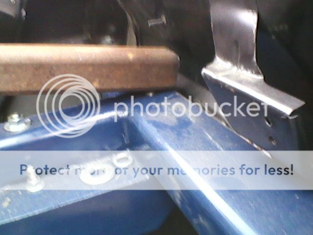

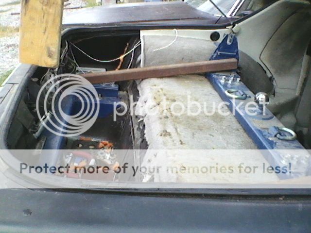

I braved the heat and tried tilting the 5er hitch, only to discover that the pins weren't bottomed in the cradles. I will need to cut windows in the deck.
The left end needs to be bobbed about 1/8" to clear the hatch strut, so I won't bend the new struts when I get them.

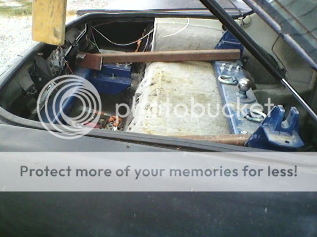

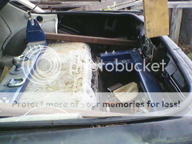

Just got the gas tank back in, no more difficult than before the bracing. Pics soon.

Posted: 07/09/12 11:59am Link  |  Print  |  Notify Moderator

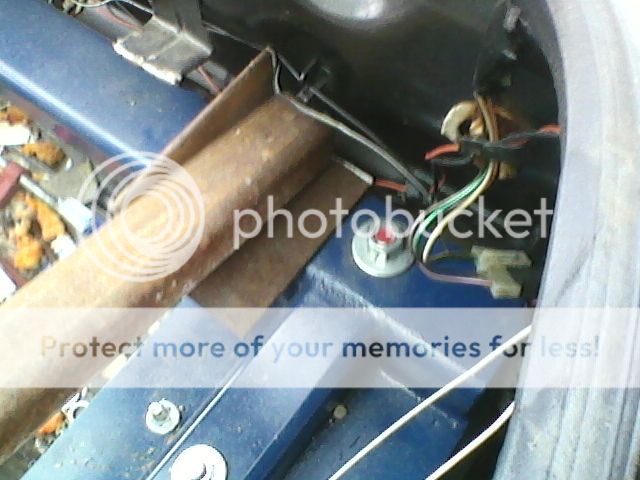

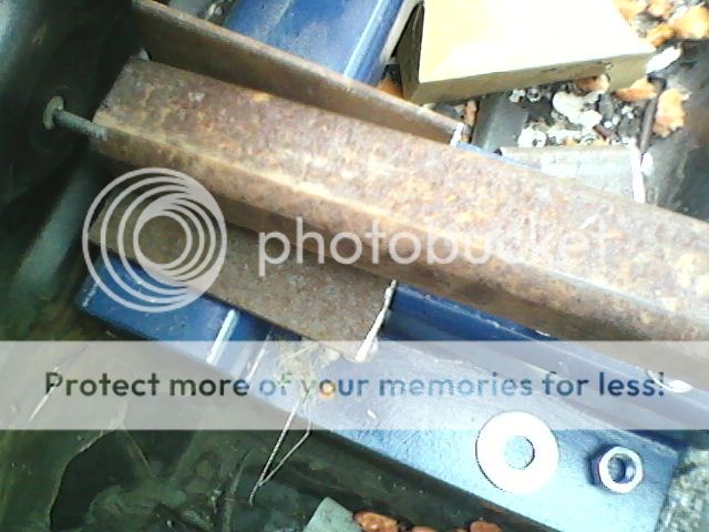

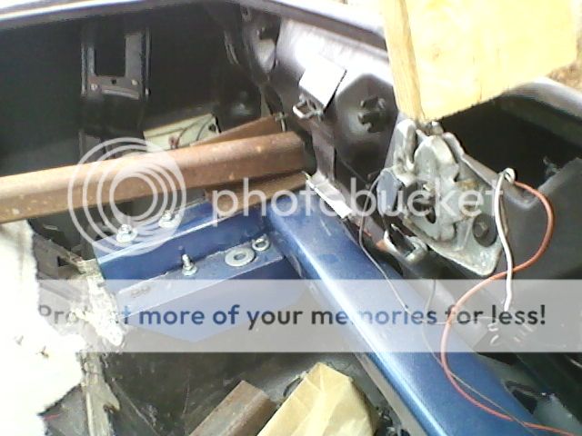

Outboard there was the original intent, but I laid the other one inboard:
And liked that better. So how to attach it?
Wait, that can be turned inboard also:
whisperide
Golden Spike area
Joined: 09/27/2011
Posted: 07/14/12 09:16am Link  |  Print  |  Notify Moderator

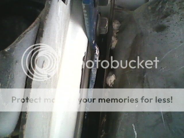

BTW, these are 2" x 2" x 0.250", 36" long, and will be bolted at both ends. I cut 4, 2 as seen and 2 more underneath. But the ground is still very wet. So, back to trying this in my asymmetrical-designed car:
I call that a problem. Minor, but needing attention.
