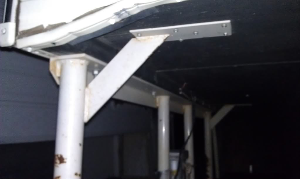

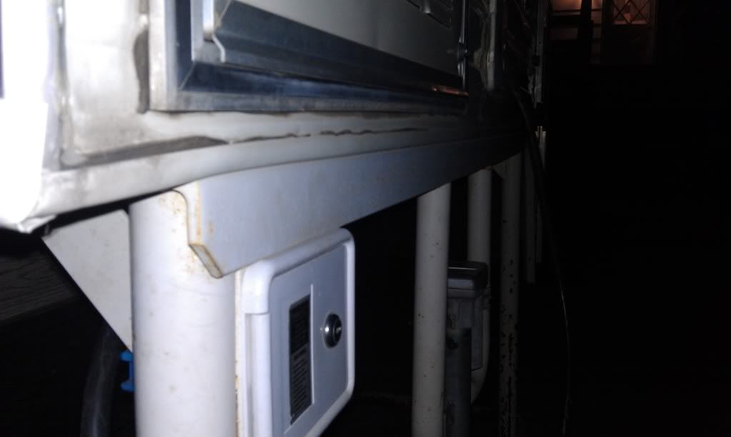

The '94 S&S that my wife and I just bought has an original factory-installed Stablelift jack system for SRW trucks and of course, I have a DRW. The camper was too good of a deal to pass up so I bought it anyways.
After researching, I found that used Stablelifts are difficult to find (impossible locally), new ones cost twice what I paid for the camper, and a set of Atwood electrics with swing-out hinges cost more than I paid for the camper.
So, I took some measurements, did some initial sketches, and over the next couple weeks I am going to take some backyard engineering skills of mine (and more importantly, a skilled friend's) and a pile of 1/4" plate steel and make this thing work before camping season really gets going.
I will post pics throughout the build as it will likely take place on weeknights about an hour at a time.
Here are some pics of the Stablelift as it sits now.

The only real difference between the single and dual stable lift now is the top plate is longer (extends under the wing more) and the tubes that run from side to side at the bottom are longer. They did away with the large diagonal brace.

A SRW truck will clear fine, the angle iron & diagonal gussets/brackets are several inches outside of the bed rails of the truck when the camper is sitting in it. My problem is where they are mounted, my DRW fenders won't fit clear. It's 89" between the tubes and my fenders need ~98" to clear with an inch to spare on both sides.
I finalized my plans today and am picking up the steel tomorrow to do it. Thirteen feet of 8" wide 1/4" plate, 18" of .120 wall 2" DOM tube, and some grade-8 fasteners aught to do the trick. Will post pics when I start surgery.
