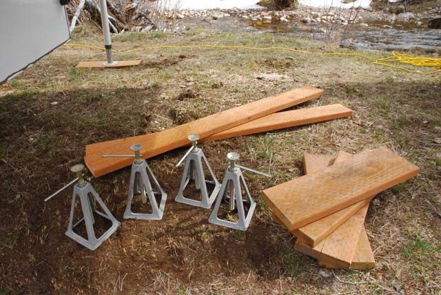

I don't like feeling motion when I am inside my camper. For the first year and a half I always used my camper jacks. Now I am using these jack stands instead. You could try this if you are worried about using battery power or wearing out your jacks. These jack stands were about $40 and they are pretty fast to set up. They take out a lot of the wobble you feel with people moving around or strong winds blowing.
They stack together for easy storage.

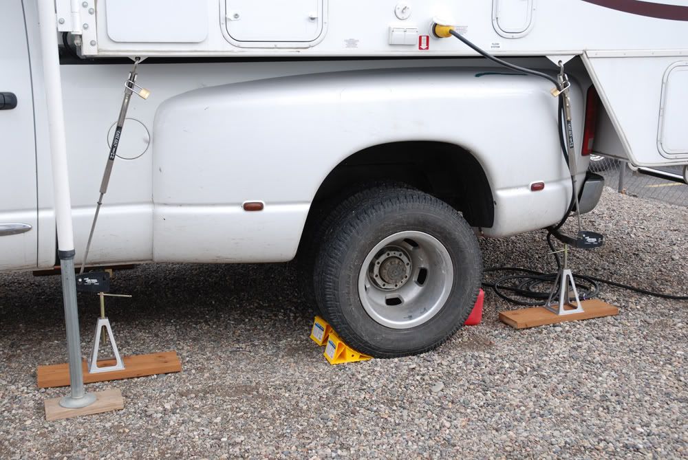

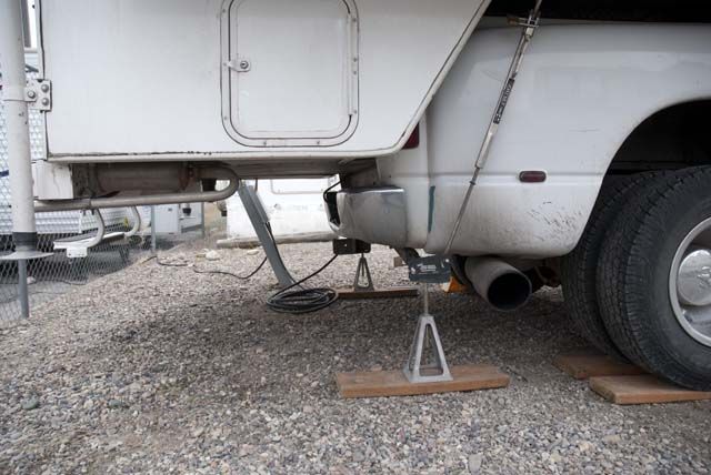

I place them under my torklift mounts to stop the trucks frame from moving.
When it gets really windy I use the truck jacks for added stability but that's rare.

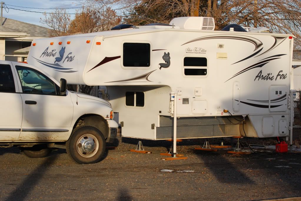

I use the long boards to support the floor of the camper when it's off the truck to cut down on the sway felt by the play in the camper jacks. I am amazed by how much wobble there is in the camper jacks alone and how much wear it is putting on the corner areas of the TC where they mount. These stands dramatically reduce the motion from play in the camper jacks.

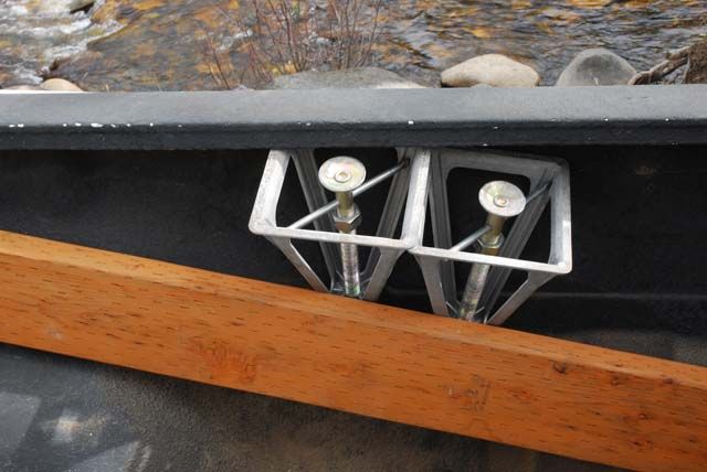

The long boards fit in the bed for storage because I only need them when I remove the camper.
You can also store the jacks here but I don't because you can only get them with the camper removed. I just keep mine in the back seat of my truck.
