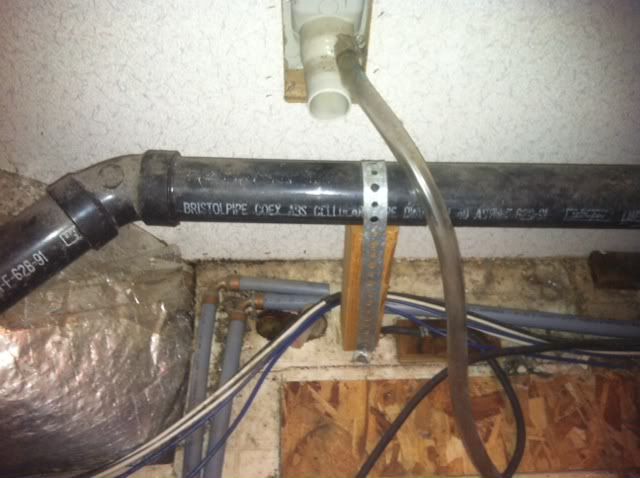

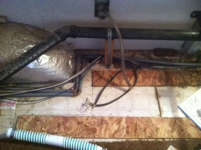

Our family is totally new to the RV scene. We bought out first TT 93 Terry Resort . Upon filling the fresh water tank we discovered that the hose that is supposed to fill the tank on the inside had been disconnected and water sprayed all over the inside. Since then we pulled out the sofa bed to find the problem but can't figure out how it's supposed to connect to the tank in the floor. There is nothing for the Jose to clamp to. In other words here is only a hole in the floor . We've searched the Internet for a diagram with no luck . Any help would be greatly appreciated.

I'm guessing that when it was winterized last the hose in question was disconnected? Are you sure you are putting the hose in the water tank fill and not hooking it up to the screw-on-connector for pressurized water hook-ups? (I'm just trying cover the obvious first) Is the fresh water tank directly under the sofa or is it under the floor. A picture would be really helpful.

What do you see when you look down the hole? No fitting? Broken fitting? Might have to enlarge the hole or drop the tank.

A pic would help. If you're lucky, the top of the tank has threads and you just need the fitting to install between the tank and the hose. If this is a gravity fill, it will be a big fitting, like about 1" I.D. You need to look down in the hole, or even stick your finger down there to feel for threads, broken fitting, tank completely missing, or ???

Here is a closer up pic .. U can see the hole In the floor with no fitting sticking out . Also what is the small clear plastic tube supposed to be for ?

Scary thought about than missing!? Yikes I'll check it out more thoroughly when I get home . Id rather not take it in if it's something simple like just getting a new fitting. How difficult is it to take the panel off of the bottom of the trailer to expose the tank?
