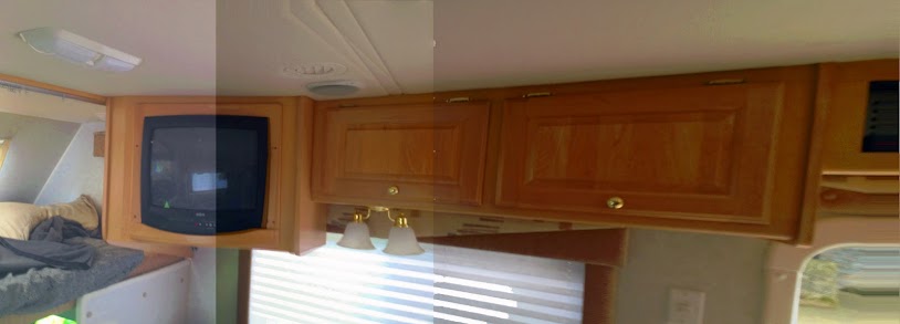

My HR Atlantis came with two TVs framed and mounted nicely in the cabinetry. After spending a few weeks looking at various flatscreen installations on the internet and differnt mounting options, I decided to give it a try myself. In doing so, I wanted to remove the TVs but preserve the cabinetry as much as possible.
First, what flatscreen TVs to use? In looking, I knew I had 110 power at each TV, but one problem is the kids want to change the DVDs and they cannot reach the DVD player which is located above the door. So I looked at the idea of the DVD built in; this ended up a problem because most of the DVD doors were behind the TV screen which would be installed in the frame.
Most everything I read said to look for a TV with front facing controls and reasonably priced, so I settled on a Magnavox 19" Class 720p 60Hz LED TV - Black (19ME402V) from Target for $149 with a $17 2 year agreement (figured this was a good idea in the RV) for the rear replacement. Below the TV, I installed a small Sony Blu-Ray Disc Player - Black (BDP-S185)which fits nicely under the TV.
I pulled two screws out and discovered that attached to the TV is a plywood mounting plate. Using two L brackets to mount the TV on the mounting plate and mounting it to allow enough clearance for the DVD player to sit underneath.
On the front TV, after shopping around, the Philips 32" LED (32PFL4507/F7) from Costco fit the requirements. Just to boost the sound, the Philips soundbar and subwoofer did the trick. The subwoofer sits underneath the dining seat since it is non-directional sound.
Now, were to install the TV? There were a number of different ideas including leaving the existing TV cabinetry, but a 32" would not fit in that space easily. In addition, wanted to free up space by the bunk.
So I opted to build a cabinet using the existing cabinet and center it above the window so even from the bunk it would be visible. Taking the existing cabinets out...
Once the tearout was complete, I made a template to ensure everything fit into place before cutting the existing cabinet.
With that was complete, the existing cabinet was measured and cut.
From there, installed the new (old) cabinet back in place.
The existing two door cabinet was cut in half and mounted on each side of the TV cabinet.
In addition, we bought a Western Digital TV Live (http://www.wdc.com/en/products/products.aspx?id=330) and using the Android hotspot tethering we were able to watch Netflix, stream Spotify and watch home movies on our trip.
I'm posting this for anyone else who takes on this project. Good luck - it was worth it
