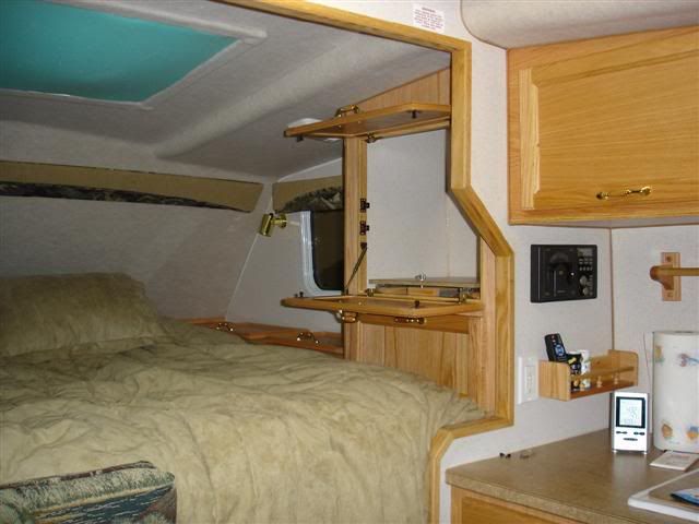

This is the before photo

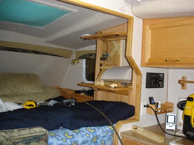

This one is with the paneling peeled down so I could install more support.

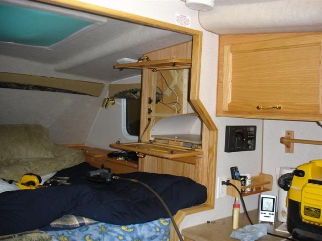

This is with new bracing.

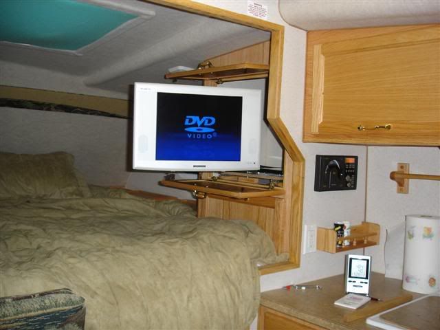

Paneling reattached, bracket mounted, TV installed, wiring run inside loom & arm fully extended.
TV facing bed

I failed to mention the radio in this camper plays CD's and DVD's and is wired directly to the TV. The arm pivots/swivels and tilts and can be viewed from anywhere. The mount is for a much larger TV (up to 80lbs) but I wanted it for the length of the arm (24"). We got the very pricey mount on Ebay with reasonable S&H.

The mount is "Universal LCD TV Articulating wall mount up to 80 lbs
Supports any LCD TV up to 80 Lbs like 30", 32",.." on the box it had "37 arm-s oem" "1002688-1". Hope that helps.
The tv is a 15" Sylvania since I have it mounted I can not see the tag on the back with the model number.
Yes the radio remote works from anywhere, signal must be able to bounce.
