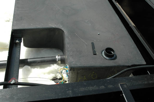

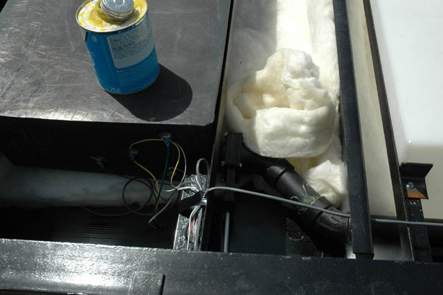

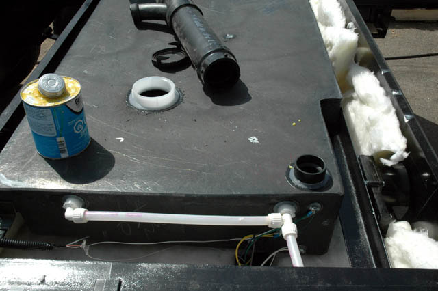

I've attached some photos of portions of an Arctic Fox 29V on the production line as the basement was being plumbed and insulated. Neither portion of the job was completed on this chassis, so don't think that the insulation was only half done. I'm showing the photos so you can see that they put insulation just about everywhere.
In addition to the insulation and ducted heat from the furnace, our 29V has both 12VDC & 120VAC heating blankets on all 4 tanks.
BTW, I like AllegroSam's idea of styrofoam insulation board between the Coroplast & the bottom of the tanks.
If you've done the homework and have those key components like the Coroplast, then do the job as thoroughly as you can. I'd stuff fiberglass everywhere.
