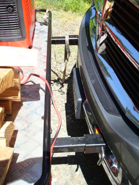

I also have seen JoeChiOhki's front cargo rack and gave it a try. I had the local machine shop take the front two tow hooks and fab two plates with six inch reciever tubes. Here are the results, rock solid.

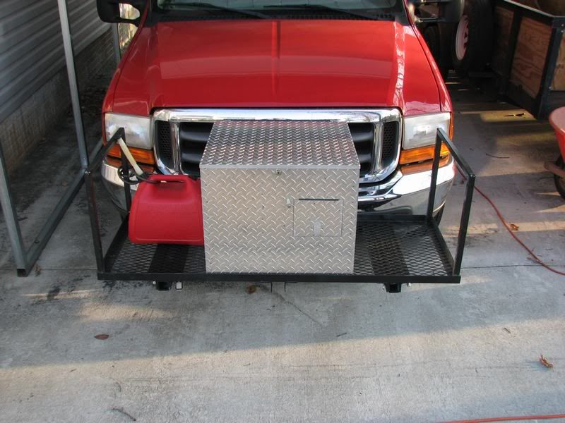

WestKY wrote:
Man that is sharp!
Do you have a picture of the whole thing from the front?
I have a front mount already but want to do almost exactly what you did.
Is the plug mount upfront for your generator?
Here's a picture of the whole thing (I plan on moving the genny box over to the side now that I have the two tubes - no more worry about it leaning to the side ):
The plug is actually for backing up my boat trailer. It has surge brakes with an electric disconnect (when the boat is on the rear my backup lights automatically disconnect the surge brakes) so when I push my trailer from the front receiver I turn on my park lights to disconnect the surge brakes.

Did you build your own generator box or did you buy one from Hayes Equip?
I built my own generator box. Later, Dave.

Elbeano, you really might want to get some 3" tube that's just a tad smaller than yer outer tube size so you can hammer a 3/4" - 1" band of it over the ends of each receiver tube to make reinforcing rings.
They help to keep the mouth of the tube from deforming with weight and road vibration, like a traditional hitch.

Hey, Joe. Even with the old single hitch point it was very difficult to get the genny carrier lined up when the genny was in the box (even with it mounted in the center). Now it's a piece of cake even with the genny mounted on the side. Thanks for the great idea. Happy camping, Dave.
