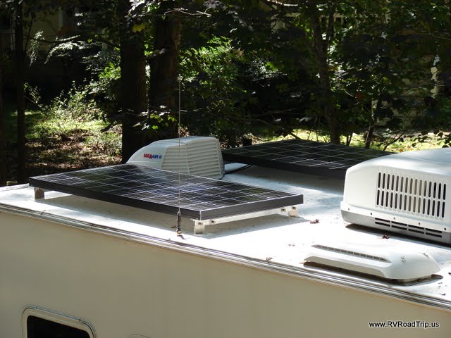

We just added 270 watts to our camper, bought the panels from Northern AZ Wind and Sun. They were good to deal with and had the best panel prices. Shopped around for the other parts at places like Infinigi.com for better prices on some items.
I only had room for 2 panels as you can see in the pic, so I got the highest wattage name brand panels I could fit. The system works amazingly well.
You can read our write-up at http://rvroadtrip.us/library/solar_install.asp.
