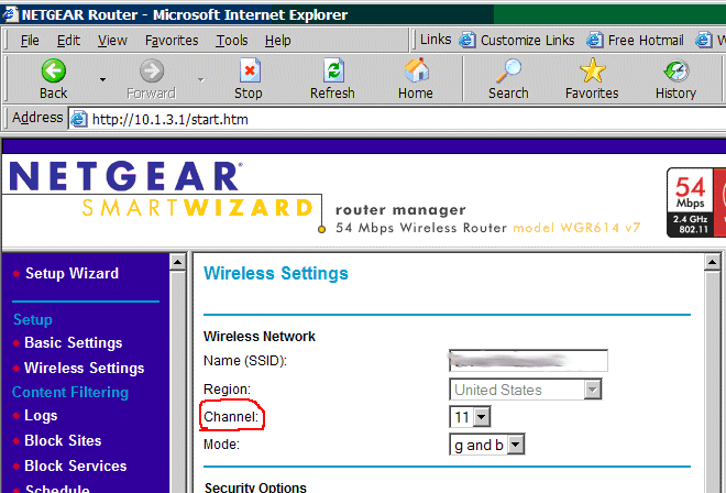

Most home wireless routers come with a default IP address of 192.168.0.1 which is called a "private IP address", it is never used on the public Internet. Also the block 10.x.x.x is private. Here is a picture of where to set it IF you have a Netgear wireless router.
The wireless router IP address is your "gateway" address, run ipconfig/all to see what yours is. (I use 10.1.3.1 in this example) Put that address in your browser "address" window and you should get a prompt to "log in". If you have never set a log in then if is probably still the default that it came with, see your instruction manual then change it after you log in. (and write it down somewhere)
