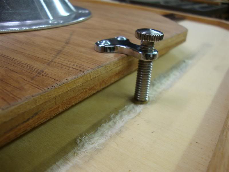

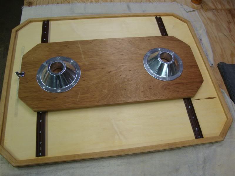

We have a Northern Lite that has the sliding dinette table, which allows us to position the table forward or back based on what is needed at the time. The only problem was the thumbscrew lock that came from the factory, we never really liked it as it was tough to use and the rubber foot has seemed to have walked away.

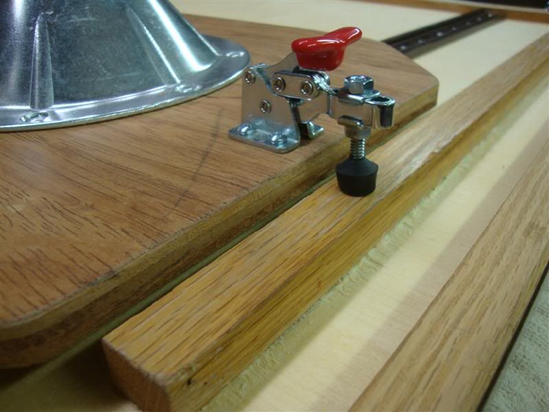

My solution was to remove the thumbscrew lock and install a toggle clamp and a strip of wood.
Here’s the wood strip installed and the new lock
The new lock is well out of the way and is very simple to operate, just push or pull the lever

Cool mod. We have the same issue with our NL. Where did you get that lock mechanism? I want to replicate what you did.

Try McMaster-Carr on-line catalog - or try De-Sta-Co for a toggle clamp.
These run about 10.00 or so dollars a piece. Very good clamps - we use them for work holding fixtures.
