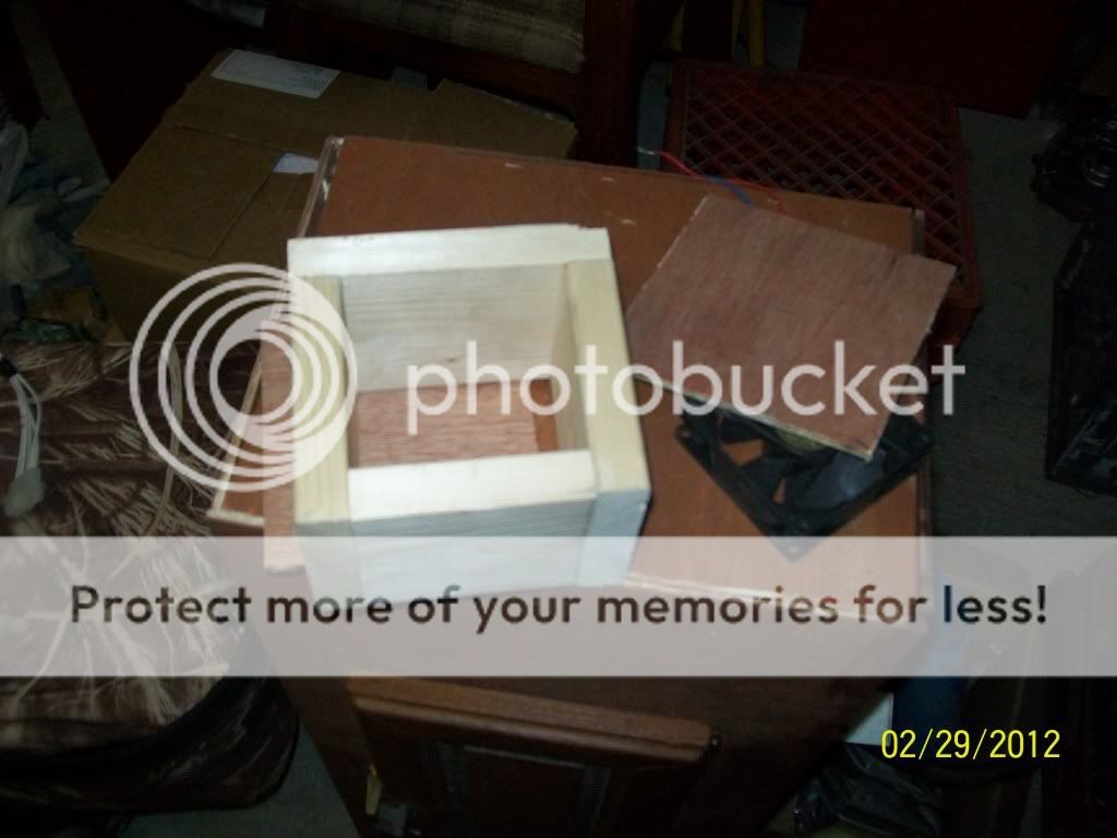

Building a box for the PC fan that will pull the stink out the Vent pipe on the black tank.

Yeah Thanks Treeseeker, Someone posted this before, Back when I was installing the computer fan inside the wall for the battery vent, Because of Gases from the black tank I'm going to install it into a box and use the screw type cap on the vent pipe so I can change the fan out, The fan in the wall for the battery's will come out from the outside, But if it ever go's bad it will have to be re-worked.
