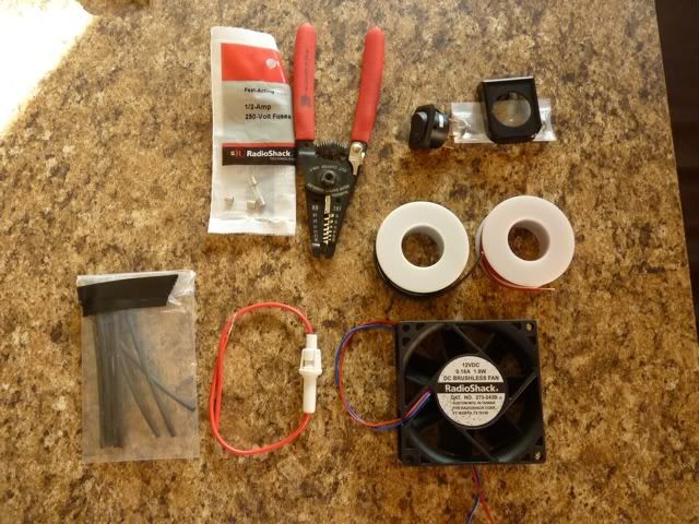

Parts for this job

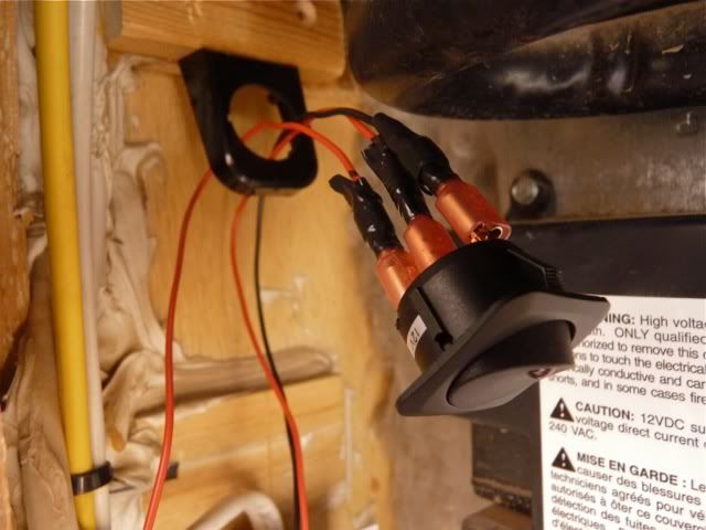

I wanted to be able to switch the fan off when the temps were lower so I needed a place for the switch. I mounted a piece of scrap wood and screwed in the switch mount.

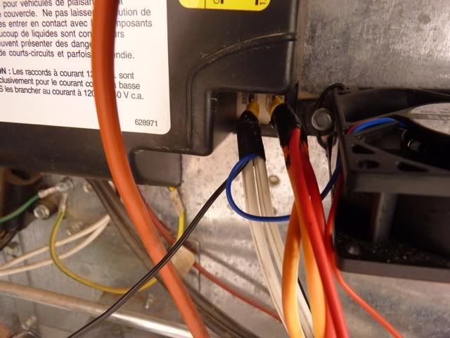

Now for all the wiring. I searched the internet for hours looking for best way to wire this as I am not electrically gifted..... at all. I saw the package the switch came in and it looked pretty basic so I gave it a try.
Hooked up the hot (with a 1/2 amp fuse from Radio Shack). Load connector went to the fan red wire. The fan blue wire went to the switch ground and to the ground in the rear panel. Held my breath and clicked the switch... it works!
Now to mount the switch and make the connections permanent.
I will have more data tomorrow but the fridge began cooling down quickly and I've set it for "3" instead of "4" so we'll see if the temps hold 38 deg on a lower power setting since tomorrow will be over 100 again.

Link to Switch
The switch I used.
Link to fuse holder
The fuse holder.
I also bought a package of (4) 1/2 amp fuses.
