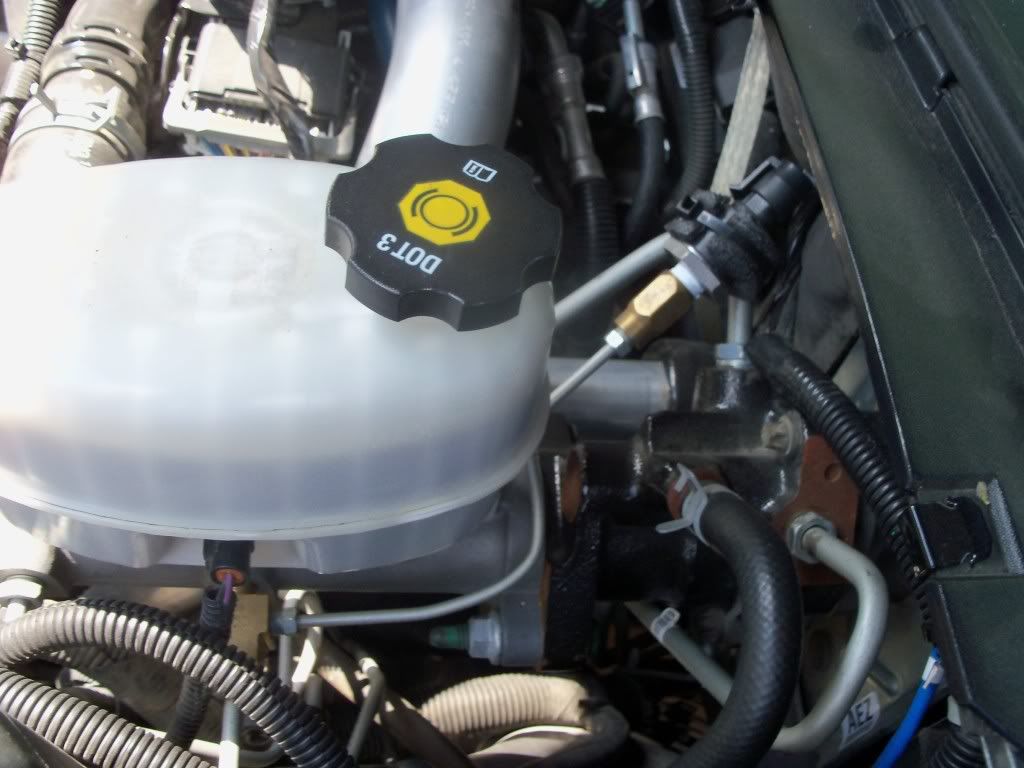

If you didn't do so, I'd recommend securing the pressure sending unit to something for support so it's not waving in the wind. I'd be afraid the brake line would fatigue in time if not tied down. I padded and secured mine to a power steering/brake booster line as in this picture:

RedG, that was the 2nd thing I did after the install! Tie wrapped it to a A/c rubber line.
