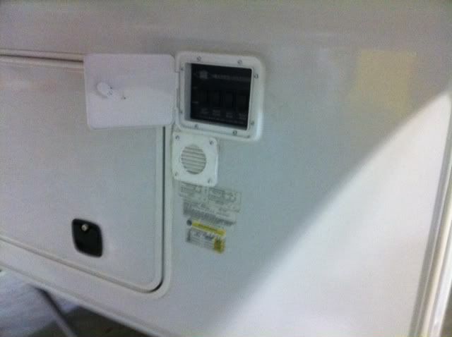

More pictures of the Reico Titan, can't wait to take it out this summer.
