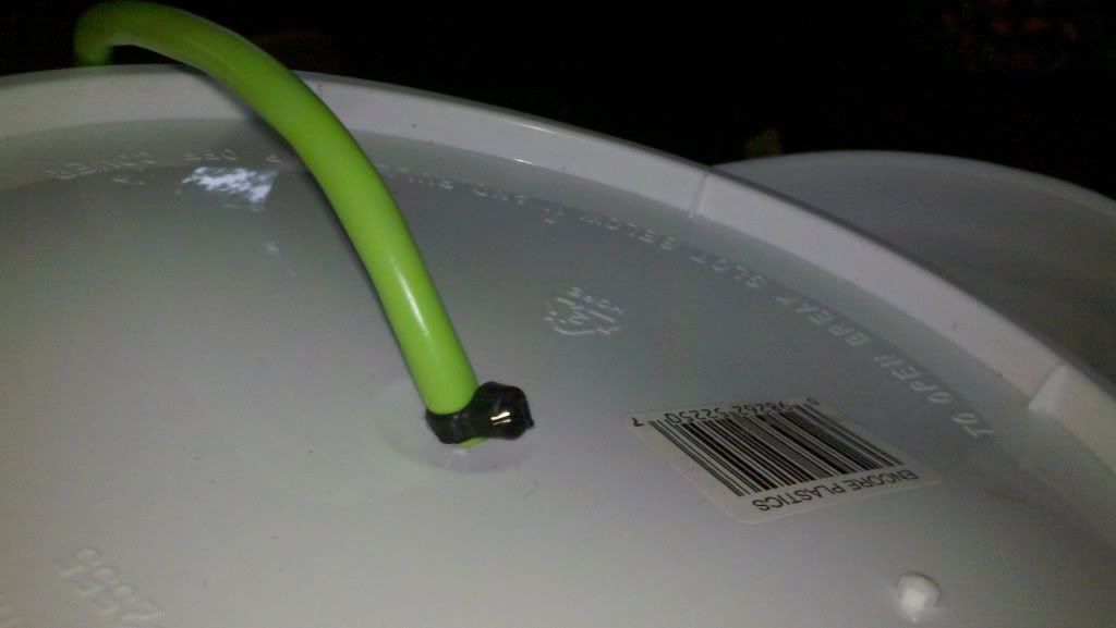

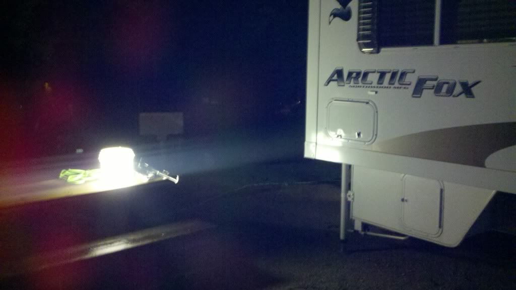

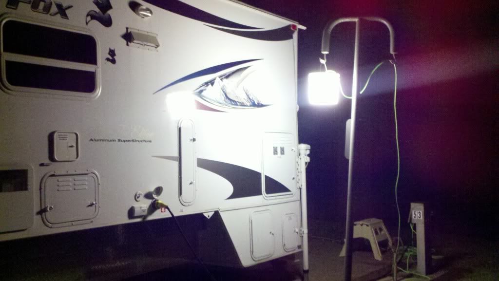

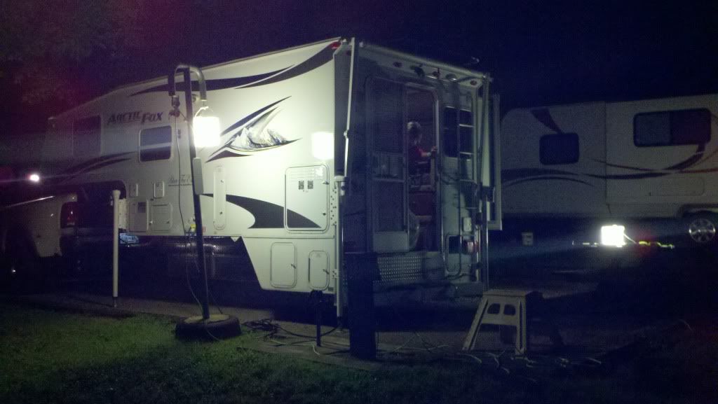

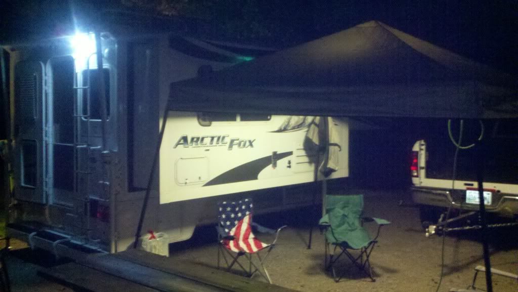

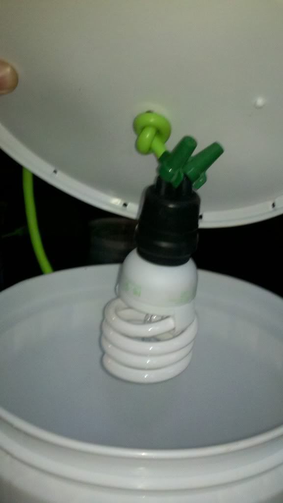

Doing my part to increase light pollution!!
I saw these at a local campground from a couple of rednecks with 5ers. Was not sure if I could find a place to carry them but had to give them a try. Pretty easy to make, I have seen better designs with a lamp socket mounted to the bucket lid but I am going to go with my low buck design until I start breaking bulbs. They are the bomb for lighting up a camp site when backing in after dark. I cut them off when not needed to keep the other campers from having to wear their sunglasses at night
125 watt equivalent CFL
Zip tie on top to keep the bulb up.
Lighting up the sewer side
Slide side
Hanging in my outdoor living room
The buckets are 1 gal from Lowe's, I used a 100ft ext cord and cut in half for 50ft on each light. Wrap the cord around the bucket for storage.

Nice. My only concern would be rain leaking in and flowing down the cord. Maybe put a liquid tight conduit fitting on the lid and run the cord through that?
Good Idea, I will give that a try.
