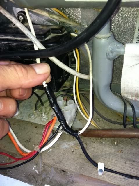

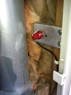

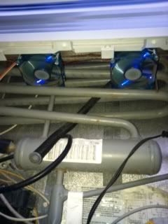

Well I'm gonna try my hand with pics using a suggestion I received awhile back. Hope it works!
Hopefully this is a picture of the mounted potentiometer.
This is where I attached the pot wires to the thermistor wires. Like I said, you can't see much. All is covered by shrink tubing. I added protection with electrical tape covered by 'liquid tape' I just happened to have lying around.
Last but not least, a couple of computer fans blowing upward across the exterior coils. Also had lying around...
