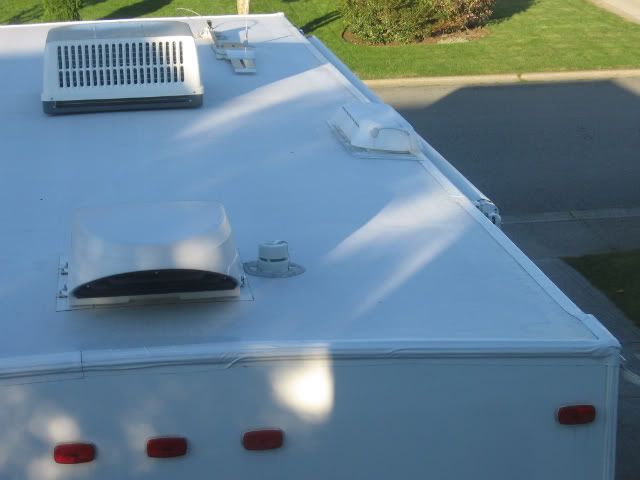

Well, recently finished putting the Eternabond on my new trailer.
Had previously done around the skylight and vent when I installed the Maxxair cover, but was waiting for a good time to do the rest...and the guts to get it started.
I pulled the vinyl 'cover' out of the gutter and ran the Eternabond from the lower lip where the vinyl was hooked into and up and over onto the roof. The first side I did was the entry side, so I had to deal with the awning, which wasn't that big a deal. Took about 3.5 hours.
On another day I did the other side and it was about a 3 hour day which included doing the front and rear seams.
Overall, it was well worth the effort and the only thing I have left to E-bond are the vent and antenna areas.
Realize I don't have a pic of the wrap into the gutter, but I'll try and get one asap.
Anyway, here's some of the finished product:
Please excuse the crappy looking rear seam. It was the end of two rolls/end of the day/pulled off too much backing and she stuck in the most unruly way

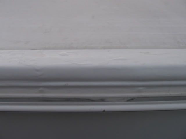

OK, here's where it wraps over and covers the gutter - you can see the screwheads under the tape. BTW, there is water on the tape in the pic....not all of the 'blemishes' are air bubbles

Ran a bead of sealant where the tape rests in the lower gutter lip. I realized (too late) that I could have just run the tape over the lower lip to the bottom of the gutter, but once I started I was committed.

I will bookmark this page, so when people ask about roof repairs, I can tell them how to make it look great, or share a picture of my RV. Yours looks great!

Nice work. That was a great idea on the awning bracket to shed the water over the side.
