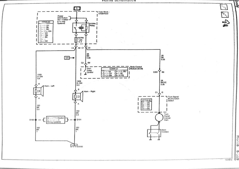

OK, looks like I've got (2) actual horns
Would it be possible- with this information- to design a '2-stage' type setup?
Can anybody give me some help on a new electrical schematic?
TIA!

It would take some engineering, but an adjustable-delay relay from Newark electronics or possibly even Grainger would foot the bill. Tie the trigger of the relay into the OEM horn and set the delay at a second or less. A brief toot uses only the stock horns, but a long 'WTF?? A-hole!!' blast brings in the big guns.
For the auxiliaries, I'd use the biggest, baddest ones I could find. Big horns require a big compressor and/or a tank to feed them.
If you want straight-up electric ones to augment or replace the stockers, look into Stebel horns. www.stebel.it They have a decent selection. The Nautilus is a common upgrade on motorcycles, and it's about as compact as you can get when it comes to air horns...
