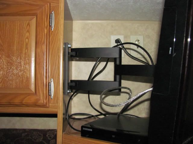

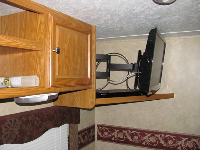

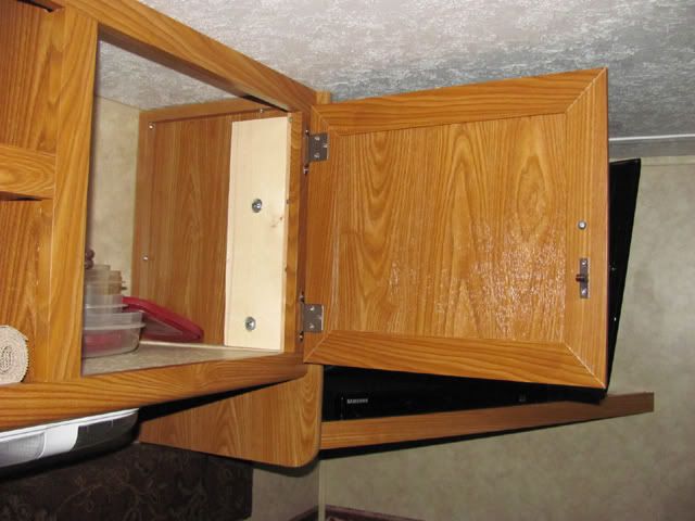

Finally remembered the camera when I went to the TT today. Here are three shots of the install of our 22" LED/LCD TV. I used 3/4" plywood for the backing plate on the inside of the closet. Toughest part was tightening the bolts from the bracket to the TV working between the wall and the back of the TV. Two inches doesn't allow much room for turning wrenches. I moved the TV down to eye level, much more comfortable viewing, and used the shelf above to house the Bose Wave Radio and DVD player. By running the audio output of the TV/DVD through the Bose you get unbelievable acoustical quality. Still tight and secure after 6K miles.

I like the support under the arm which limits cantilever effect.

I added a piece of wood on the inside of the cabinet (scab) to add more support.
