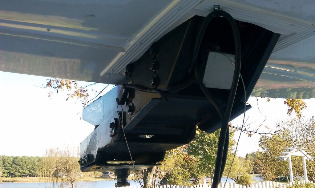

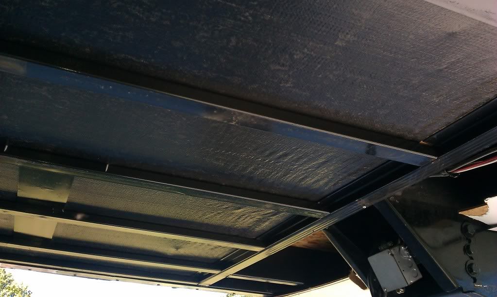

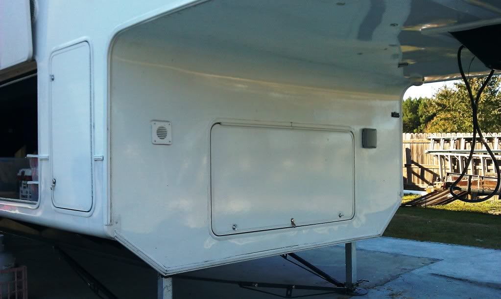

To the OP, yes, I have dropped the front skin on the overhang.
It is a relatively easy job taking it down. It does require 2 people to actually remove the skin just because of it's size. It is not heavy just hard to handle by yourself.
Putting it back is another story. I am sure the factory guys can do it alot quicker than I did. It took about 4 hours to get everything lined backed, reinstall the screws and caulk everything.
To drop it, ,
1)at least on my trailer, remove all the rubber molding covering the screws. lay them down flat in the sun so they are pliable when you reinstall them.
2) Remove all the screws around the front storage compartment and remove the door and frame assembly.
3) If you have a light under the pin box, remove the mounting screws, disconnect the wires and remove light fixture.
4)Remove any trim you have around the pin box.
5) Remove all screws from perimeter trim and front cap. When you begin to drop the skin, start at the bottom below the storage door opening. Pull it down and towards the front of the trailer, this will remove the skin from the front cap.
This is what you will see-
Back together-
Going back up, just reverse the order. Getting the skin above the front cap was the hardest part for me. Once it is in place above the cap, it was easy to get everything else lined up.
Hope this helps.

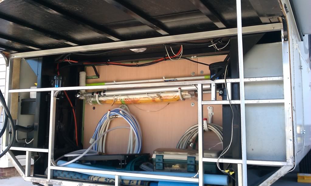

Just as a side note, here is one thing I did once I had the skin dropped.
* This post was edited 04/11/12 12:53am by an administrator/moderator *
