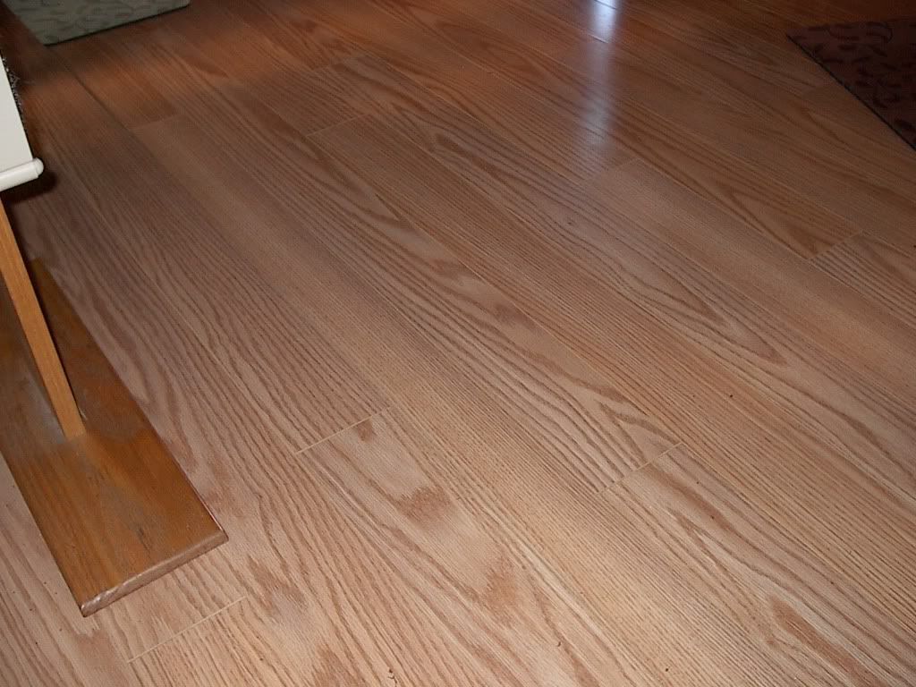

I did both the dining area on my slide & my kitchen floor. The slide carpet came up much easier the the flooring in the kitchen area as spray glue was under the carpet & contact cement type glue was used in the kitchen area...I have flush floor slide-outs & didn't want that foot wide strip of carpeting continue running the full length of the slide out...so I spent a couple of days playing with laminate pieces(as in two pieces that would be glued to the kitchen floor & two pieces that would be glued to the slide out floor) until I got them where they were just right where they close enough together but didn't jammed on each other when the slide moved...that was the most time consuming part...once past that everything went down in a half of a day.
Two boards to the right of the darker wood table leg is the slides out's edge...after that starts the kitchen floor.
Would absolutely do it again, & would recommend to anybody...
Dog hates it tho...as he can only run straight across it...no turns...lol.
...Please ignore the dirt...

Jcrowford,I don't see where the slide out floor meet the main floor.How did you do it?

The quickest way to describe the install, where the slide flooring meets the kitchen flooring, is like putting two fingers pointing at each other with the finger nails barely touching. The slide out laminate's leading edge received a 45 degree cut in one direction & the kitchen floors edge received a 45 degree cut in the other direction, again...just like how your fingers fall away from each other...& what your looking at is just the top edges(like the finger nails) almost touching...the gap is too small to see...it took hours to assure same outcome every time the slide stops in position...but the final look was certainly worth it...

Excellent idea JC.JC one more question a 6mm or 8mm laminate wood floor will be OK to replace the carpet?The thickness of the wood will not interfere with the slide out?

I used Swift Lock Plus & it was a high gloss(plus part) natural oak from Lowes...& is 7mm in thickness. As far as transition of the slide onto the the flooring...I just cut small pieces of the laminate & put them under the top edge of the ramp the slide out rollers use to "climb" to floor level when they come in...wanted to make sure the rollers were truly @ floor level before rolling across the kitchen floor...that said...I own an AutoMate 5th wheel...& they were know for doing things a little different...& this is what worked for me...but no Buc...no interference in my install w/7mm & I think the rollers would handle an 1/8 inch difference between ramp & floor if, let's say, you couldn't get to the top of the ramps to modify them....long winded way of saying 8mm would just fine to use also.
