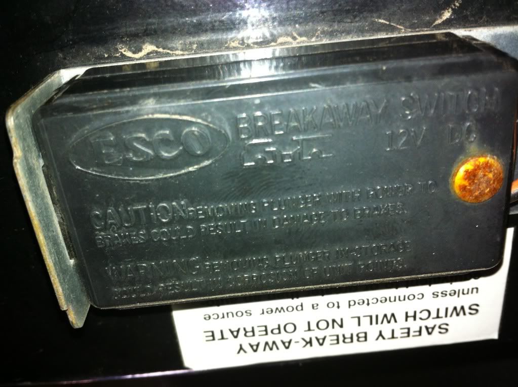

Just finished putting the travel trailer away for the season and pulled the truck away - not realizing the breakaway cable was still attached - rookie mistake I understand...

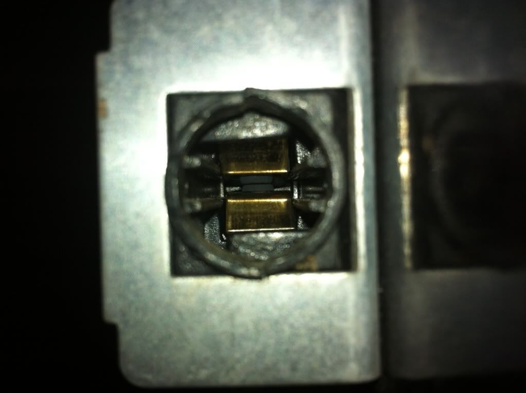

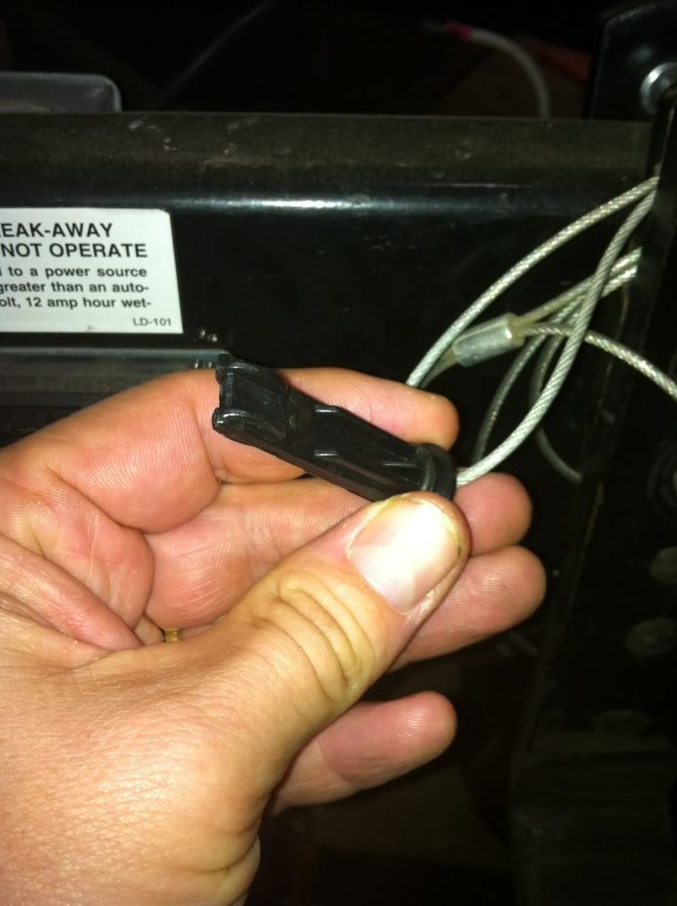

I tried to simply re-insert the plastic "key" into the unit only to realize that the magnets within the breakaway system were blocking the path - which simply tells me the breakaway switch actually worked.
Now, how do I release those magnets so I can re-insert the key? Simply sliding the key back in does not work. Have tried many things, disconnected the battery, etc. but to little avail. The magnets are still as shown in the picture above.

Push harder, it will go in. Those are not magnets, they are part of the connection that holds them in.

The brakes will not release until you separate the contacts in the break-away switch; that's what the "key" on the end of the cable does. The key is plastic and is not a conductor of electricity, what your are calling "magnets" are merely spring loaded contacts that connect the power from your battery to your electric trailer brakes.
You need to insert the "key" until the round end on the key (where that cable attaches) is within the round socket end of the break-away housing to completely separate the contacts. I would spray the inside of the break-away switch with silicone spray, and if necessary, use a small hammer (a tack hammer) to tap the key back into the switch until it is all the way in. That should drive the contacts apart and when the round end of the "key" is mated to the round entry of the switch will serve as a "seal" to keep dirt out of the switch.

That was unexpectedly easy. Just went back out there and simply pushed a bit harder and in it went... I pushed like a steer last week but it wouldn't go, and this morning, it slipped right in.

Ditto... It's just a tight (spring-loaded) fit. It takes a fair amount of force to get it back in (I know several people that have broken theirs trying to reinsert it).
