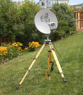

I put together a tripod stand using a surveyors transit tripod very similar to TV4RV's. The tripod cost me about $60.00 as I recall. I used a chainlink fence pole and had a friend weld it to a flat metal plate to mount on the tripod. I have used it for years.
I use one of these to tie down the dish. We've been in some pretty hard winds and never a problem.

Hey John am looking to make a setup like yours but can't tell from the pic just how the bolts at the corners (which I assume are used for leveling) operate. Care to clue me in? Thanx
Jonesz
Johno02
Lexington, TN USA
Joined: 10/15/2004
Posted: 12/29/11 09:24pm Link  |  Print  |  Notify Moderator
I used four "T-Nuts" in holes I drilled, then used a Dremel tool to cut scredriver slots in the ends of the bolts. T-Nuts are threaded inserts which look kinda like a T. They have a top that looks kinda like a washer with prongs, and all you do in insert them into a hole so that the prongs go into the wood and hole the nut in the hole. Your local hardware store should have them to fit the carriage bolts. I use a cheap power screwdriver, battery powered to screw the bolts in or out to level, and if needed you can swing the legs a bit to fit the terrain. I have never had this one blow over, although wind did rotate the dish out of line one time. The dish fits the pole tight enough to hold it in most cases. using my compass, I try to aline the center board in the currect direction, then just tweak the dish to find the bird. Most times, the dish will line up exactly with the center board, but it doesn't make any difference at all. Just however it fits the terrain.

Noel thanx for that-will look for some T nuts.
