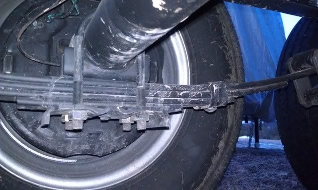

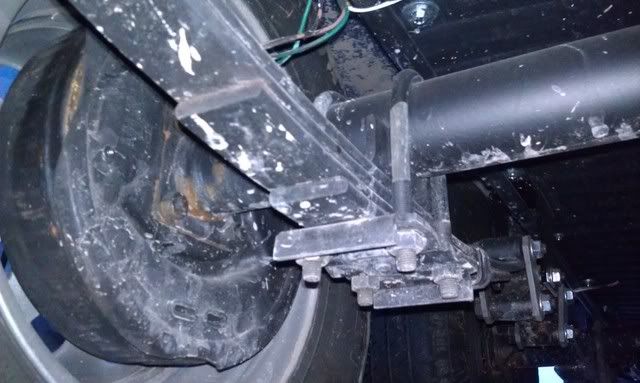

Here are what my axels look like. Looks like they could moved to under the spring.

Trailers are like race cars; the lower the better.
If you must do this and if it's a straight axle you can just spin the axle 180 degrees. No need to weld a new perch on.
You will also have to reclock your brakes if you do this.

While I'm not certain my trailer axel is like this, I've been told they are always bowed to help with loaded weight distribution. So literally flipping the axel would put the bow in the wrong direction and the tire camber would be way off and you'd get a messed up ride and tire wear.
What is reclocking the brakes?
Thanks.

The bow is called camber. And that is precisely why you don't literally flip the axle.
reclock = relocate -- a reference to detaching the brake backing plate from the axle, turning it upside down, and then reattaching it so that the brake functions properly.
Although that would fix the braking problem with literally flipping the axles, it would not solve the negative camber issue.
Getting the perch welded on is not a big deal.
