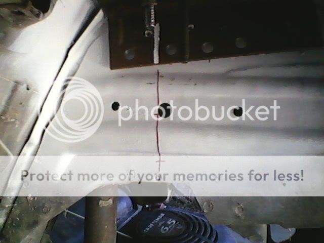

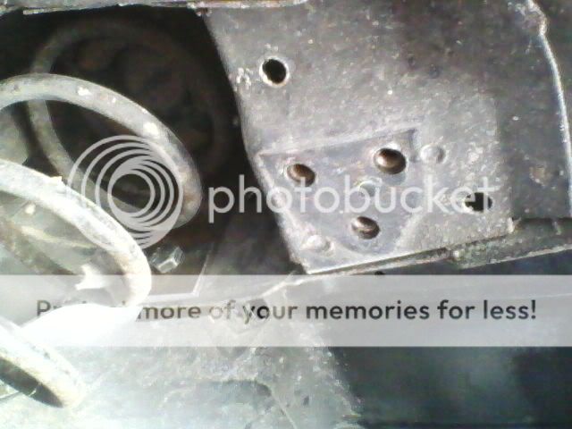

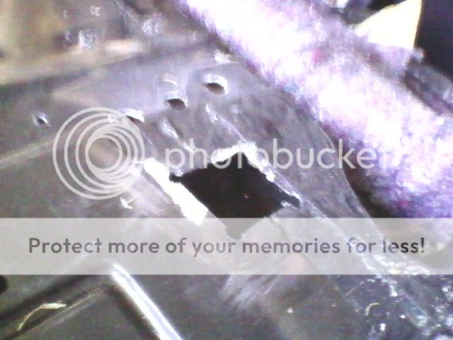

A bit of measuring got me ready to drill:

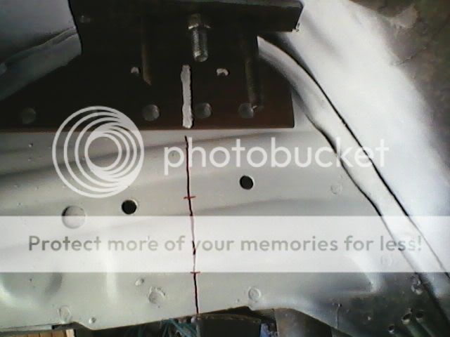

Which led to some drilling:
Moving on, note the ball location:

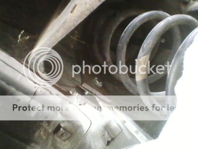

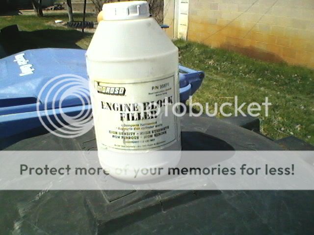

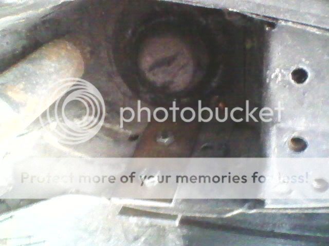

I have NO clue why, but GM created a void above each rear spring. I see fit to fill them full of engine-block-filler, used for racing. It's a concrete that doesn't expand or contract as it sets. Perfect.
I had to cut access holes to do the top row of side fasteners anyway, so I'll fill through these:
But at that point, I reaized all my filler would run down the subframe rails, so I tried this:

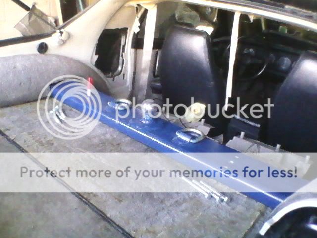

Meanwhile, to take full advantage of such perfect weather, I was progressing up top:
That's all for now. More soon!

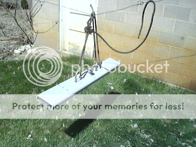

So, while I'm adding to the under-floor brackets and bracing;
Here's the neighbor 16-year-old helping, not that I would ever tow with anyone sitting back there:
And then I wanted to see if I could fit a (padded) roll-cage bar past his shoulder / head
But I was too interested in getting the pics to correct his posture, so I'll have to shoot 2 more pics.

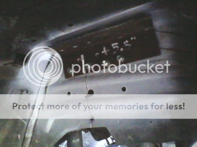

3 gussets there, all 3 have since been welded in. Were this visible, or were I building another, I'd just start with 4x8" angle, so no welding.
I still need to remove all this one more time to scale how much weight I'm adding.
