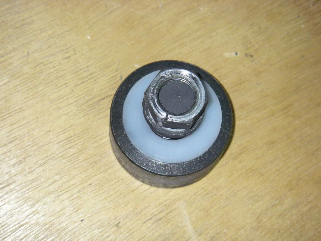

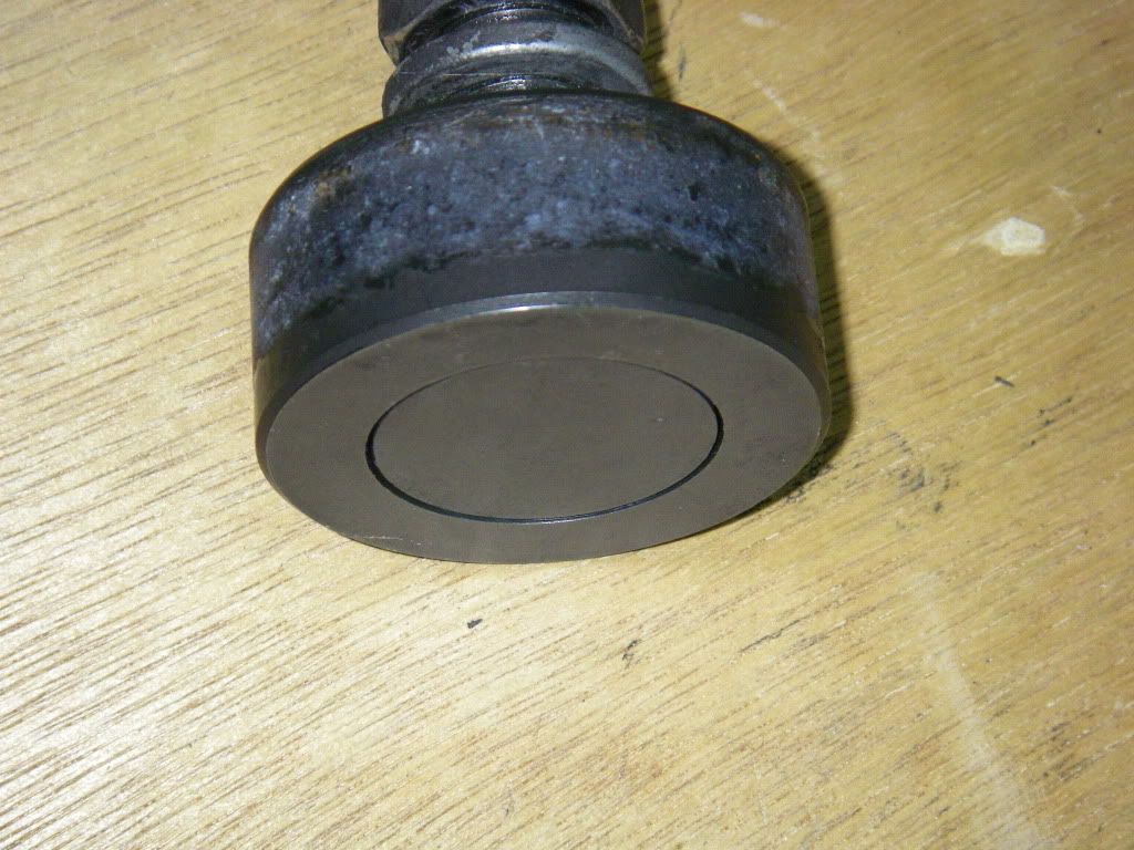

Newer version is like this - a much better design as a sleeve bearing:

I have the old design as it is a ball bearing with slightly rounded outer edge.

Photos of my failed bearing for future reference.
