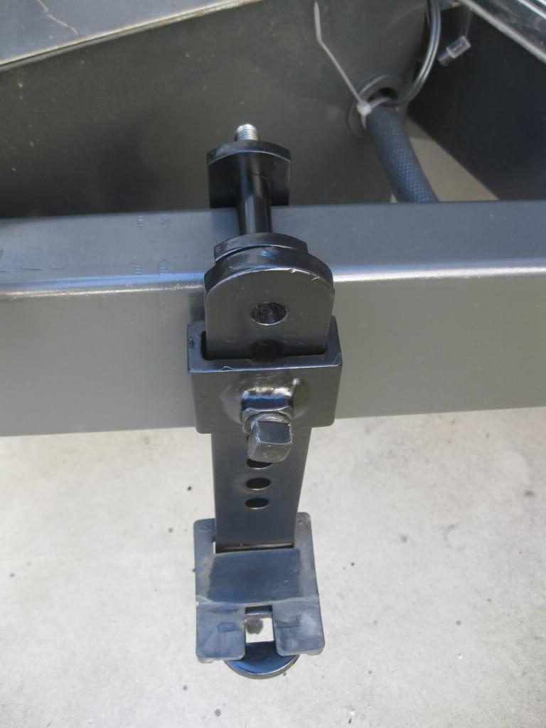

Hi, I have posted this before, but I have some new pictures of my cure. The tubing that I use is 1/2" copper because it will give a bit. (crush) My brackets no longer move. I have had this set-up for several years now.

vermont_blue
Colorado
Joined: 04/29/2010
Posted: 01/29/12 11:09pm Link  |  Print  |  Notify Moderator
Thanks for the great idea.
