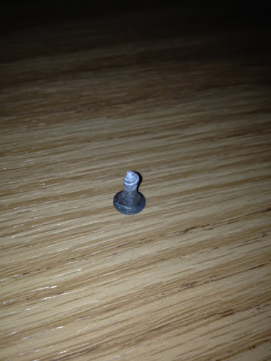

Posted: 02/06/12 08:29pm Link  |  Print  |  Notify Moderator
I have only removed half of the headliner, but this is what I found so far on the passenger side. As you can see, one screw is sheared completely off and another has backed out half way.
If I have the clearance, I am thinking about using bolts and lock nuts rather than these small screws that will most like shear off and/or come loose again. Although this solution may not look as nice on the floor of the overhead bed, it will be covered over by the slide portion of the bed. Any additional thoughts or ideas are greatly appreciated.

I recently got this same maddening squeaking sound right above my head in the cabover of my 94 Tioga. Took it to the shop where they confirmed it was coming loose where the horizontal connects to the vertical, just as described in the earlier posts on this forum referred to above. They replaced the rotting vertical and horizontal moldings on both sides and the old cab seal and put it all back together with longer screws, just as recommended here. For me it was worth the 6 hours labor and $50 parts charge to once again hear only the rattles my radio can drown out.
