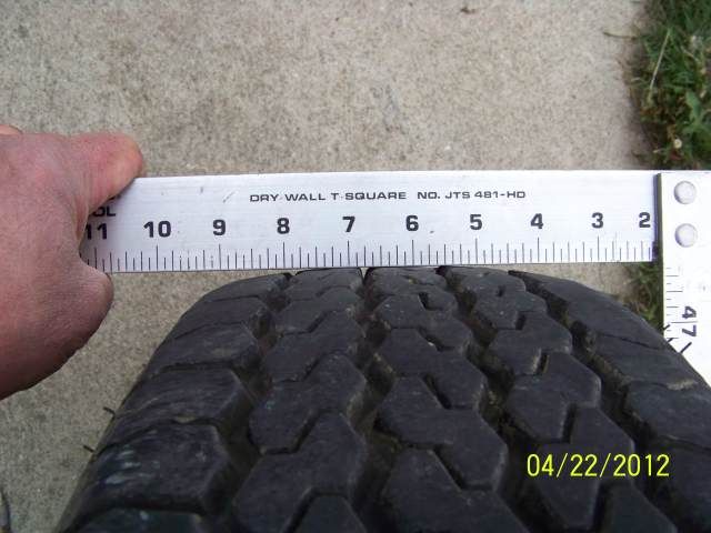

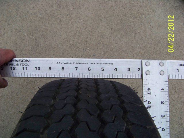

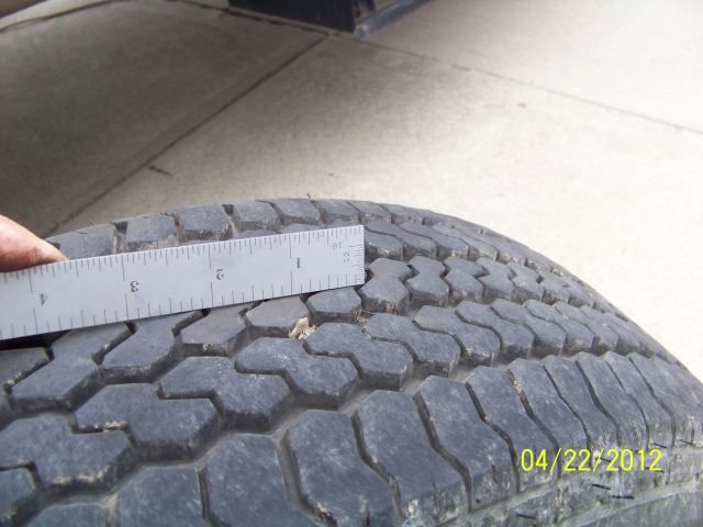

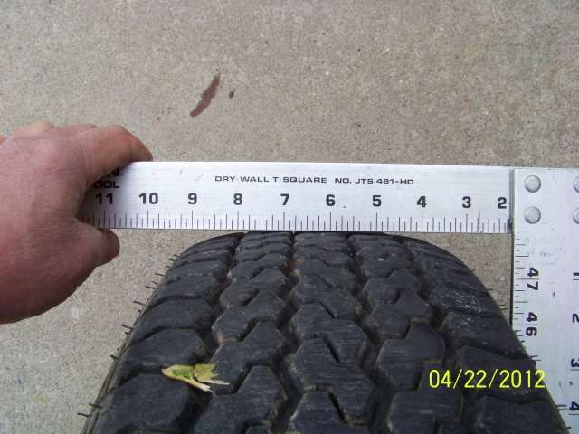

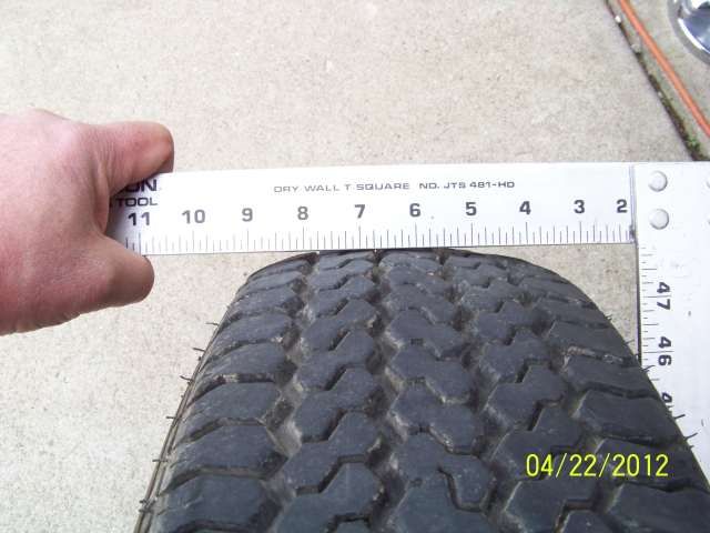

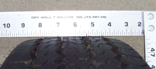

And the spare tire. This tire only had about 50 miles on it. I used it ounce when I had a right side tire valve leak. It has sat in my front cargo hole the rest of the time. I am using a dry wall square and the long blade is on the outside of the tire. This will show on every tire the same way so you know the outside. I'm using this as my control for tire roundness. This is at 65 psi

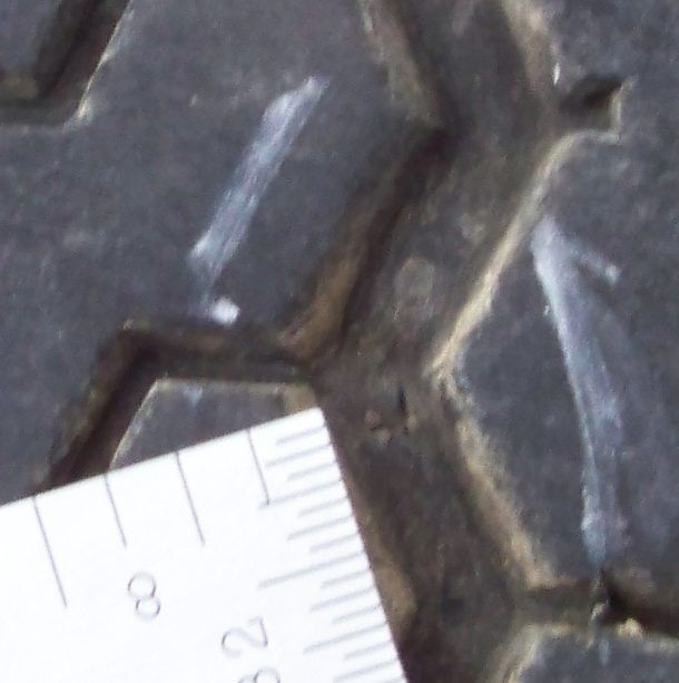

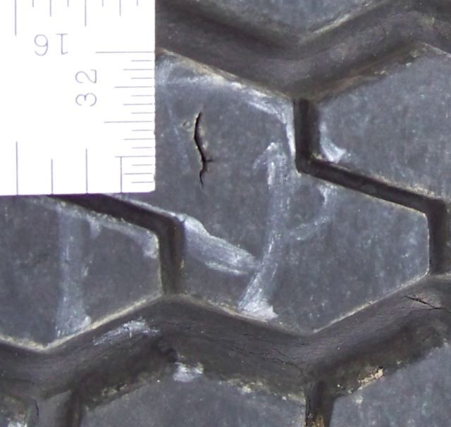

Here is some of the info to add and clarify as there may have been some misunderstanding on the good tire and the bulge tire. All tires have some kind of tread splits and fine side wall cracks.
Left rear tire: The problem bulged tire that started all this. I looked it all over today. There are some tread splits and side wall cracks. This tire has towed it's last for me. It will not leave the yard on the camper.
Here is the bulge
And 180 degrees from the bulge
Side wall cracks.
Tread splits

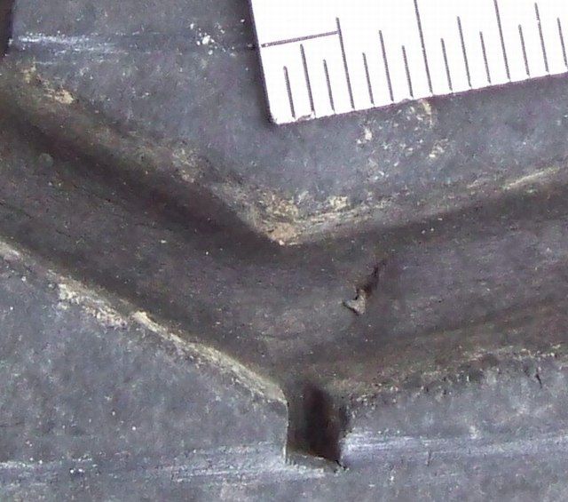

A problem are with 3 splits in one area.
close up - This is about 6" from the start of the bulge
more close up
The other close up

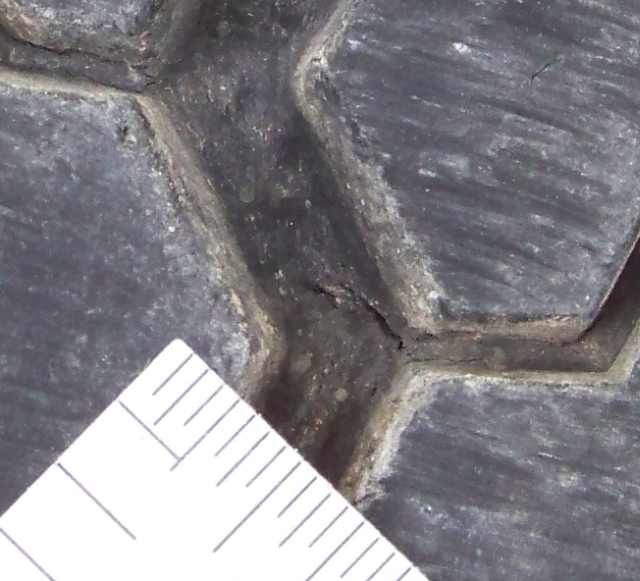

Now to the other 3 tires.
Left Front Tire:
Thread splits. There are 5 areas
Area 1
Area 2
Area 3
Area 4
Area 5

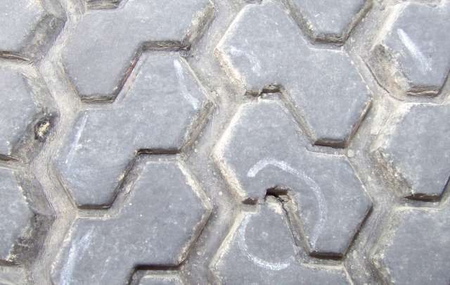

Right Front Tire:
Tread Splits: There are 3 areas and a strange depression

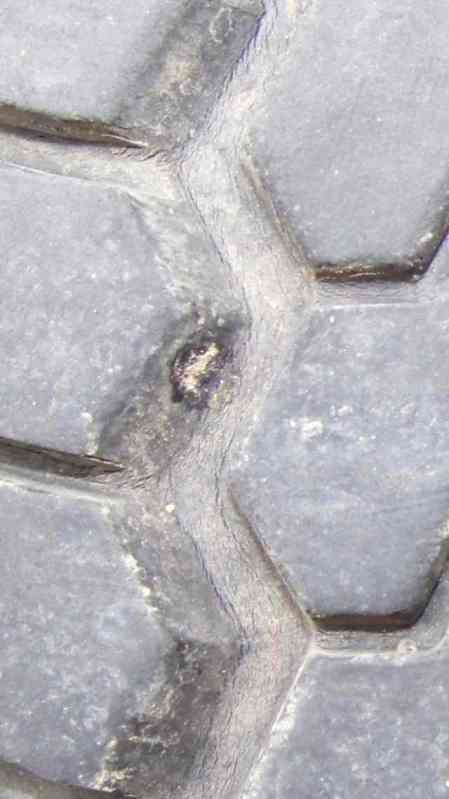

Area 1 This must be a stone cut.
Area 2
Area 3

A pattern in all the tires, the outside edge is wearing from turning I do believe. I do rotate the front to the back tire and on both sides. But I can see a trace of rubber on the road every time I turn much going down the road. I never studied this before this set of tires. Tandem tires just scrub in a turn.
Alignment was mentioned. I worked through this before these tires where installed. More here if you want to see this: TT axle alignment & install - Detailed (long lot's of pics)

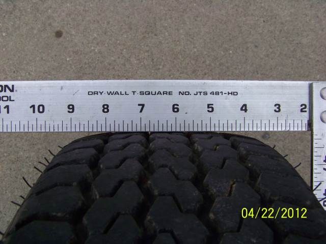

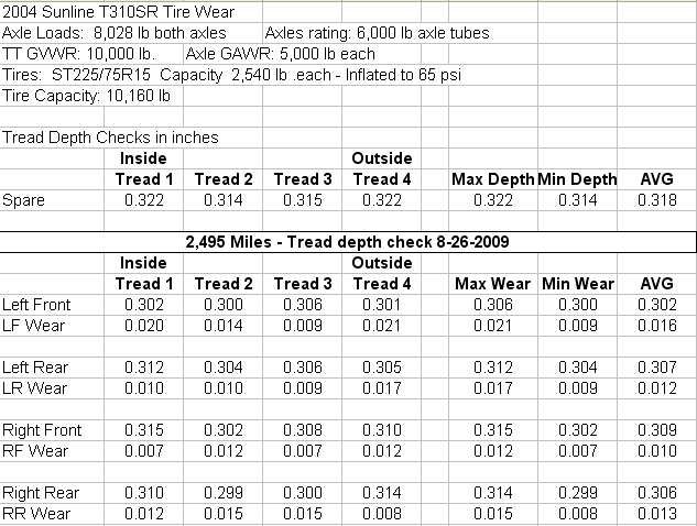

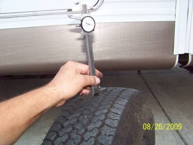

I track the wear on these tires to see how even they are wearing by measuring tread depth across the face. I do not know how the tire industry does this but this was my method.
Here is the 2500 mile wear check. You can see the middles are wearing slightly more as I am running 65 psi and the tires are not fully loaded. I have more data but have not uploaded. As of today, I have no tire wearing issues other then what I believe is turn scrubbing. A TT can be aligned to be spot on.

John,
I'm not going do duplicate the photos. Gawrsh, they took up a whole freaking page!

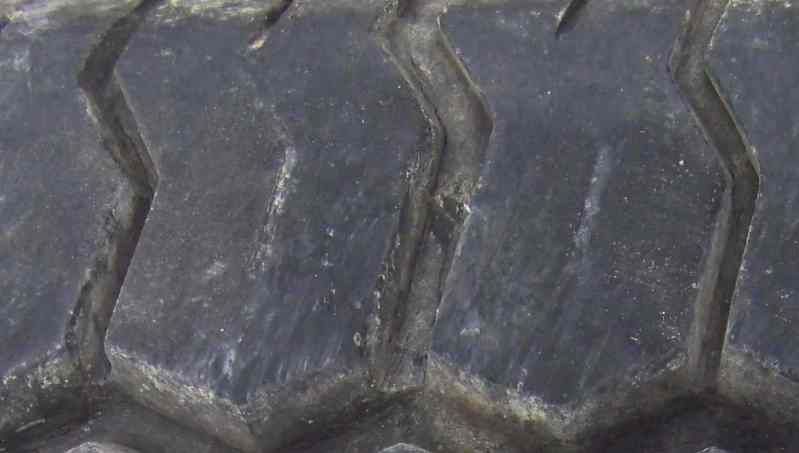

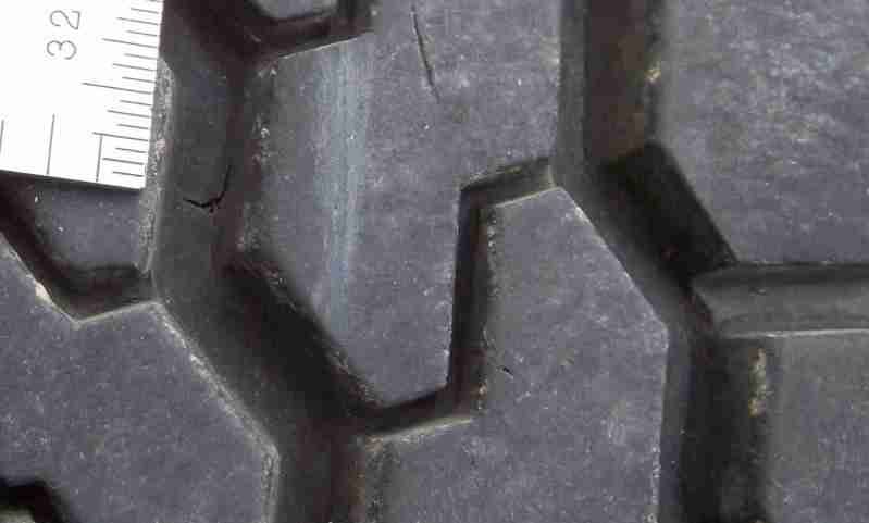

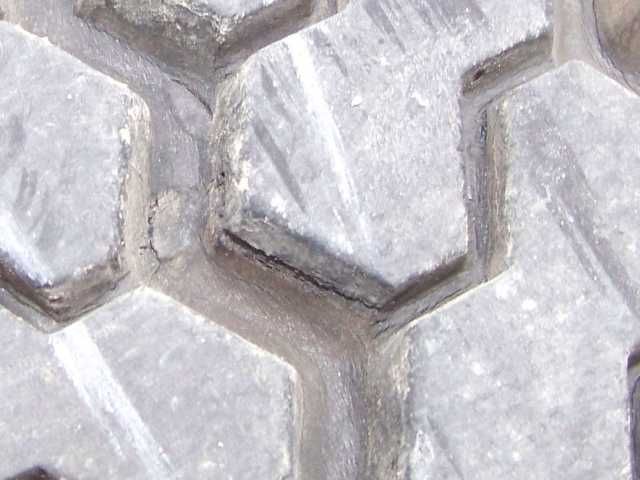

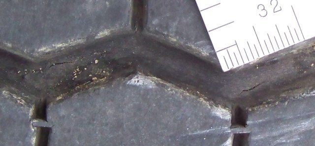

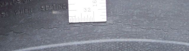

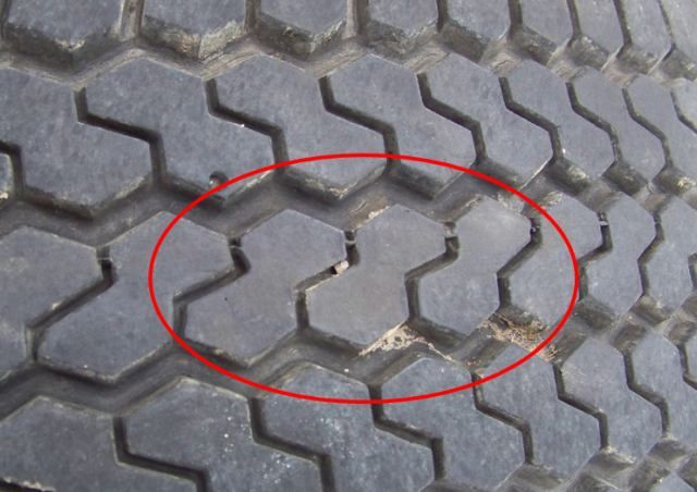

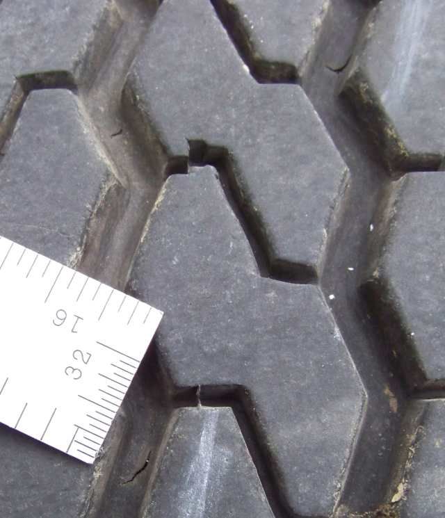

But I will comment on the ones that show cracks or cuts. So in order:

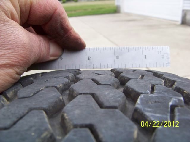

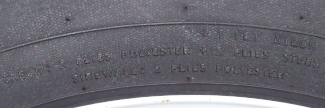

1) Construction Details: Yes, 1 nylon cap ply
2) Tread Radius Shot
3) Another TR
4) 3rd TR

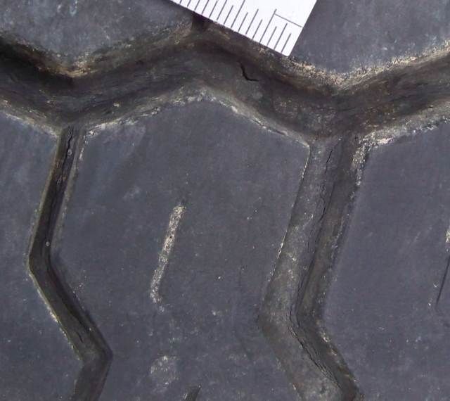

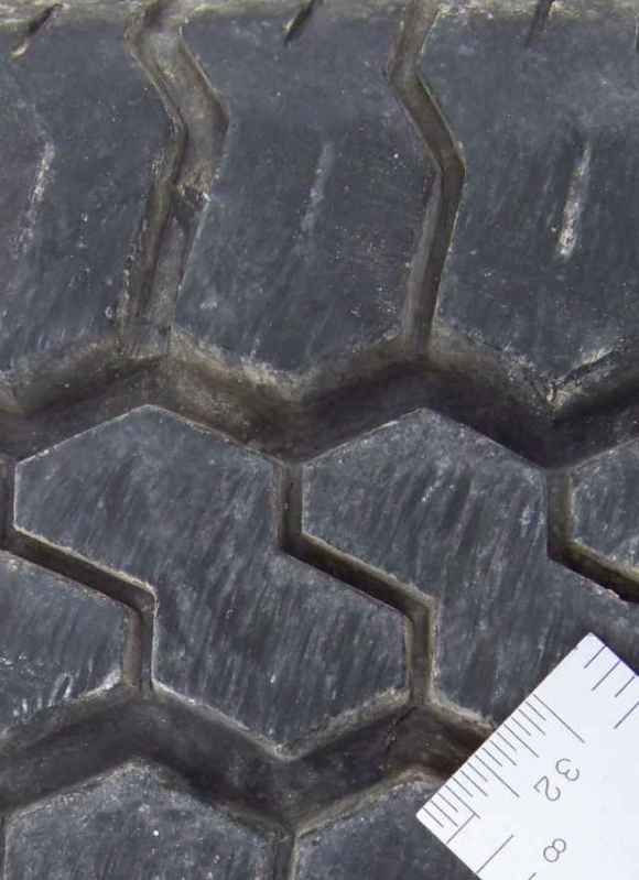

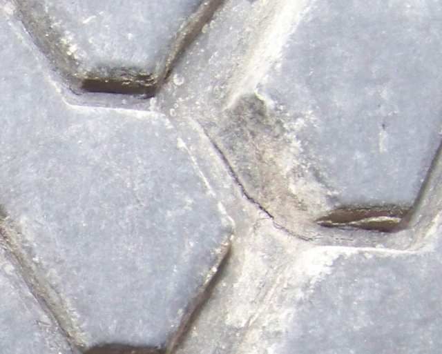

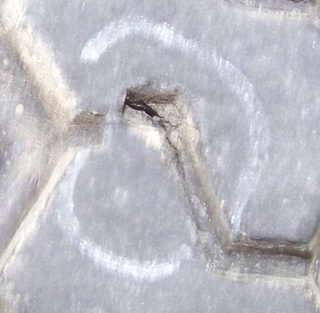

5) Lower Sidewall Crack - just over the line
6) Tread Cracking - Just inside the line
7) Cut
8) Cut near scale, cracks in other places
9) Cracks
10) Cracks
11) Tread Radius Shot
12) Cut
13) Hard to see what it being photographed, but those must be cracks
14) Yup, cracks
15) Cut
16) Cut
17) Cut
18) Tread Radius Shot
19) Cuts
20) Cuts
21) Cuts and a lug tear (not a crack)
22) Tread Radius Shot
23) Area 1 - Cut
24) Area 2 - Slight Cuts
25) Area 3 - Cut
26) Photo of Tread
27) Photo of Tread Raduis with depression
28) Photo of scale with tread
29) Photo with caliper.
That should exactly line up to all the photos.

In general my opinions on what is seen in the pictures matches Barry's. I am sure that Barry and I would have a great time trying to agree 100% of the time even if we had the tires in our hands.
My definition would be that a crack initiates within the tire rubber and there are no signs of initiation from an external object. A cut is started by some external cause. Either way if the cut or crack grown such that you can see or feel the belts with a flat blade screwdriver it is deep enough to cause other problems.
