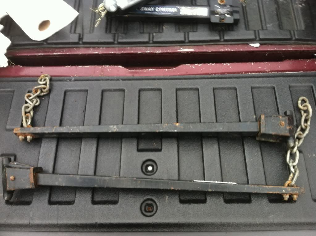

Here is the best deal on Reese Dual Cam Sway Control Part 26001 on the net today, (at least that I can find)
eBay Auction (Not Mine)
For a brand new kit for approx $145.00 its an absolute steal. Its more than $50.00 cheaper than any kit on the net that I can find and more than half price what PPL wants for theirs.
I think that this kit is out of production now, so they are just going to get rarer and rarer.
I am sitting here in anticipation of my Dual Cam Sway Control kit, I know that I am going to have a lot of work ahead of me, hopefully it will not be that bad. Not really sure at this point though.
Here are some pics folks.
Here is the hitch head with 7 washers. It is a trunnion hitch, which works better, I think, for my top mounted coupler with 6 inch frame rails. maybe I am backwards on that.
Here are my 1000 lb Husky WD bars that will be modified to accept the Dual Cam adapters.

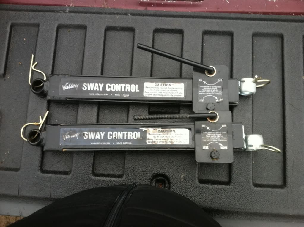

Dual Friction sway control that is going on Craigslist once I successfully install the Dual Cam system
No more worrying about the WD bars crashing into the coupler while turning sharp (It's not just backwards you have to worry about folks!)
No more worrying about the friction ball mounts being bent because of a too tight turn (backing up or going forward, doesn't matter) Notice the left sway bar mount is slightly bent in towards the hitch ball? Yeah, it can happen.
