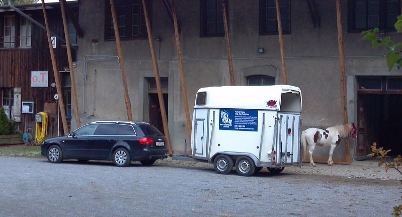

RinconVTR wrote:
flash82 wrote:
Sometimes I think we should learn more from the European market. They tow with sedans, both big and small, No WDH, no sway bars. Am over the pond often and see this all the time. A lot of the sedans are diesel and the campers are comparable to the same weights as our 20'-27' over here. Go to a parking lot over there and an American minivan will stick out like a huge vehicle.
A "small" example I snapped in Luzern, Switzerland (Lucerne) last Fall. You wont see this in the USA!!! An Audi pulling a horse trailer. Its rated in the US for 4400lbs per Consumer Reports, and you can bet its higher in Europe.
Moderator edit to re-size picture to forum limit of 640px maximum width to avoid scrolling.
actually the brenderup (the horse trailer in the picture) is the lightest of all the horse trailers. It lists a 2600 lb gvwr for a 1 horse trailer and 5500 lb gvwr for a 2 horse trailer (the one in the picture appears to be a 1 horse trailer but I could be wrong, it is hard to judge from the angle). In the US we use 13-15% of the trailer weight for tongue weight. In europe they use significantly less tongue weight. This article will help shed some light on the brenderup horse trailers.
As to your chart. While it can be helpful, it does miss payload and tongue weight capabilities. Can we add that for comparison to show the vehicles true capabilities? That would make it a more fair and accurate comparison.
