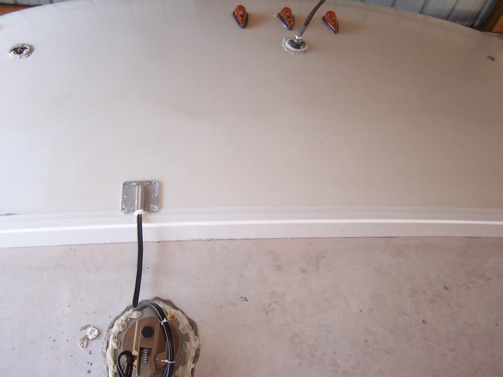

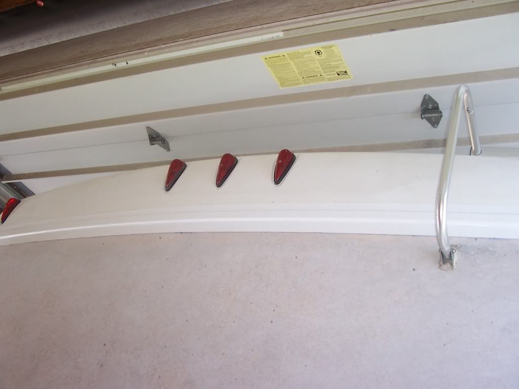

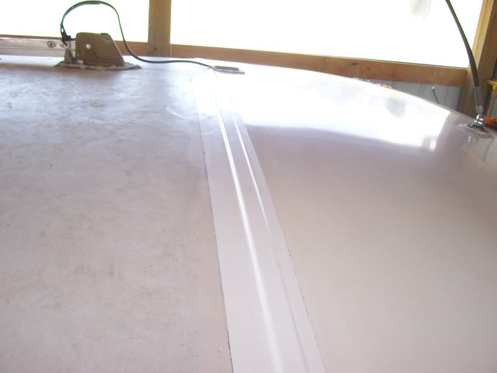

Use Eternabond tape and it will be the last time you need to worry about it.
Here's some photos of my roof seams after removing the built up Dicor caulk and applying the Eternabond tape.
Roof to front cap joint:
Old caulking removed and joint strip screws countersunk flush.
Same joint with Eternabond tape applied.
View from side
Roof to rear cap joint:
Curb side roof to sidewall:

Nice job Steve! Looks better than the gobs of caulking I've seen come off the assembly lines.
