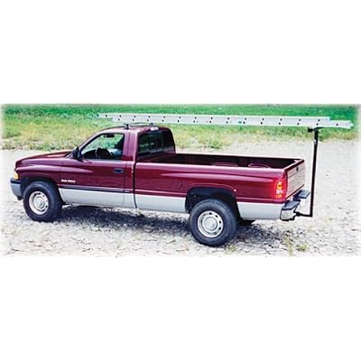

The racks on top of these vehicles are rated for at least a couple hundred pounds, so I don't see any problem of supporting a canoe up there.
I would install a front receiver like this Curt Custom Front Hitch. Then get a Hitch Extender and use in the vertical position to support the canoe out on the front of the truck. Problem solved and you have a long axis on the canoe for the tie downs rather than just the 4 or 5 feet on the roof of the truck to keep it snug.
Here is a picture of the hitch extender in the vertical position. This is obviously on the rear but it will work the same up front.
