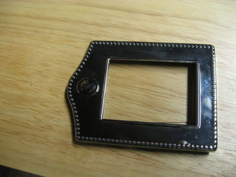

Just took a trip to he dollar store, one of my sources for small metal bits. I was thinking some sort of cookware like cookie cutters may make a good shroud for mounting the panels but they didn't have anything in stock like that. I took a trip down another aisle and spotted these small metal card frames:

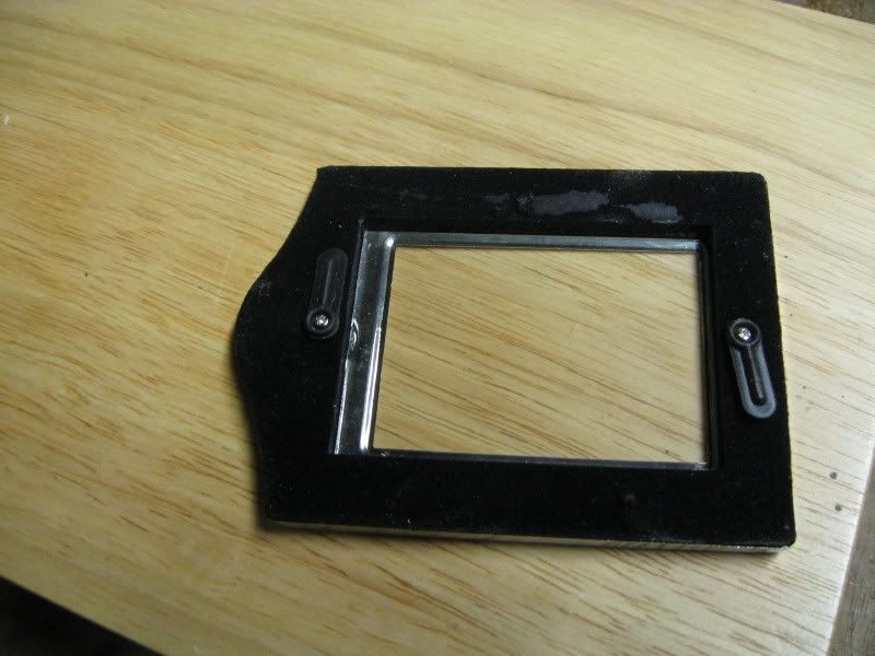

The back of the frame without the back cover:
This frame has a piece of glass and I'm thinking should be big enough for the 36-1210 panels. What do you guys think? It would be easy to mount and would be a very small profile, also. I can cut a piece of aluminum plate to cover the back of the frame and remove the black matte portion of the frame. That should hold up to heat and actually dissipate it fairly well.
camperpaul
Wherever I park my travel trailer
Joined: 05/10/2006
Do it...
If you have an old (pre 1995) bottle of "Fantastic" or "Formula 409" cleaner, read the label...
If there a "WARNING: If sprayed on glass, wipe off immediately." then it's the right stuff.
While wearing heavy rubber gloves, coat one side of the glass with the "cleaner". Let it sit for about an hour then rinse with a lot of water.
Those two products contained hydrofluoric acid which will etch the glass and give you a fairly good light diffuser.
If you want to get artistic, you can draw simple pictures on the glass with "Dykem" before doing the etching. The Dykem can be removed with rubbing alcohol.
