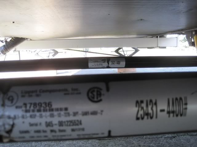

Undersized axles of inferior quality (Lippert) = 2 bent axles.
Partialy agree. I have 2 Lippert axles that bent. Don't know why. But they are not undersized in my case. Each one has a 4400# rating. x2 =8800#. My TT weighs 72-7300# loaded. The place where I took them to get straightend mentioned that they were made with soft material. So ya the quality is inferior, but they are rated okay.
I thought only Dexter made a 4400 pound axle.
They may but so does Lippert
Wow . . . they don't list it on their website.

I know, I was looking into replacing them with something better and didn't see a listing on Lipperts either. I was going to with Dexter but I thought I would give these another chance. It cost me if I renember right about $190.00 total to have them straightend. The biggest problem out of this is I now have one tire thats toast. One tire thats 1/2 worn and 2 tires that are worn normal. So I put the spare on in place of the toasted tire and will run the TT the way it is for a few trips till summer, then replace 3 worn tires to match up with the spare. I won't have more than 5-700 miles on the spare so all 4 tires should wear about the same. PITA

FWIW my 4400# axles are 3", don't know how thick because you can't find them listed on the Lippert site. Which I find interesting.
