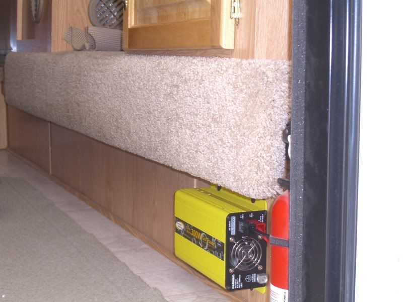

I power my tv, dvd, laptop and charge small items with a Go Power 300w sine wave inverter.
I mounted the inverter behind the fuse-breaker panel. 12v connects to the main battery feed to the panel. 120v is wired into the entertainment area circuit with an automatic transfer switch. The wiring is very straight forward if you have done any home wiring before. The Go Power 300w has a provision for a remote power switch so with the touch of a button I have instant power.

I went with the Go Power and connected directly to the batteries.
