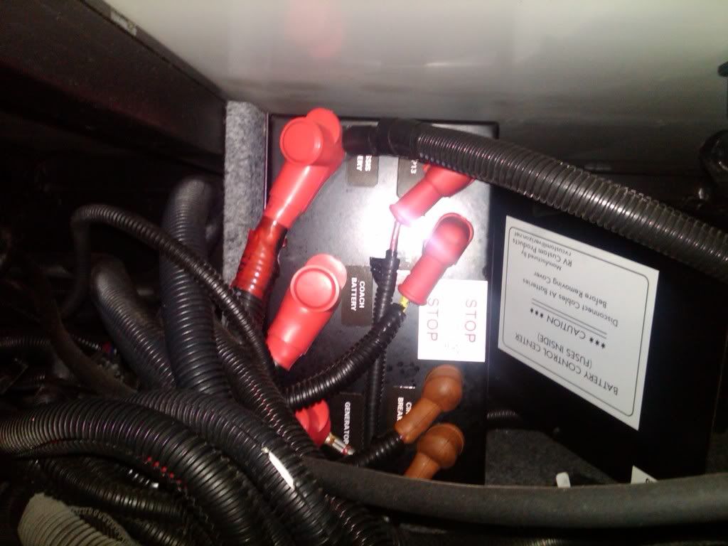

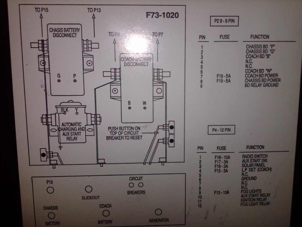

ok 1st is side of box,2nd is diagram on inside of lid,3rd is looking right at box tried to focus on soleniod behind circiut board,4th is what i think are chassis and coach batt relays?

Wow, they did not consider service in the design. Only compactness.
Well, yep, looks like you need to remove the circuit board, unless there is some tricky way of getting in there I can't see. The silver device in the middle of picture number 3 is the AUX solenoid.
If I was relatively secure my testing isolated the problem to the AUX start solenoid, what I'd do after disconnecting shore power and all the batteries, is mark each wire with a stick on numbered tag, then write the tag number right on the circuit board (CB) before I removed it. There may be some wires attached to the back of the CB as well. But you should be able to pull it up and out of the way to access the solenoid.
The AUX start solenoid in your system is a continuous duty solenoid, because it also closes to charge your house batteries via the alternator. That's important to ask for when you go to NAPA for a replacement. It'll cost 2X what a standard starting solenoid will (I paid $26 for one up in Alaska last Sept).
