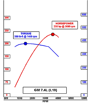

It all starts at the characteristics of the ICE. Here is a TBI 7.4L. Mine is
7.4L vortex but don't have a copy of it's HP/Torque curve, but this one is
close enough (mine is a bit higher...410 ft/lbs torque instead of 380)
That torque curve telling on where I should be towing at, no matter what gear
am in
Then notice that my red line starts at around 4,200 RPMs, where small
blocks are just getting into their sweet spot

BenK wrote:
Don't use that intersection of the two lines as your "sweet spot" because the X-axis aren't symmetrical. An NA ICE will always overlap the tq/hp numbers at ~5250 rpms.

#40Fan wrote:
You beat me to it #40. Unless this chart is in something else besides HP and ft/tq, something is very wrong with it.
What happend to 5252?

Posted: 03/27/12 11:43pm Link  |  Print  |  Notify Moderator
meant on the tach...
Not the HP/Torque curve
Trying to show how the comments are out of context, as most have small blocks
that can spin up to 2x where a big block can't do.
