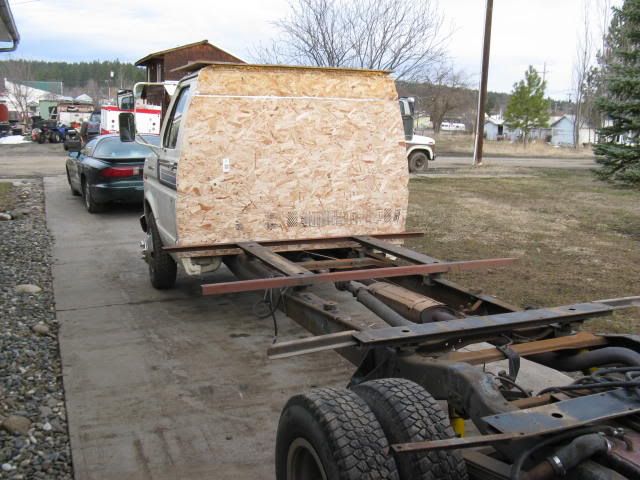

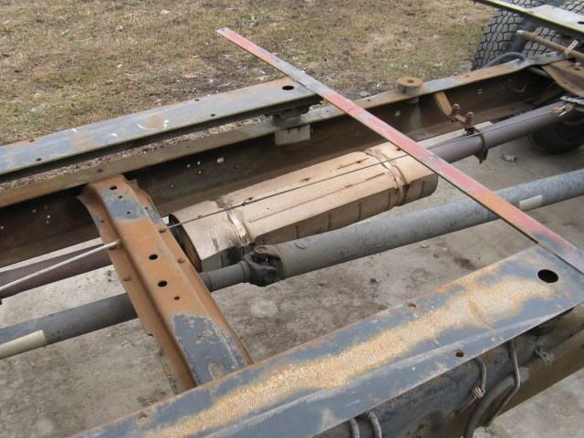

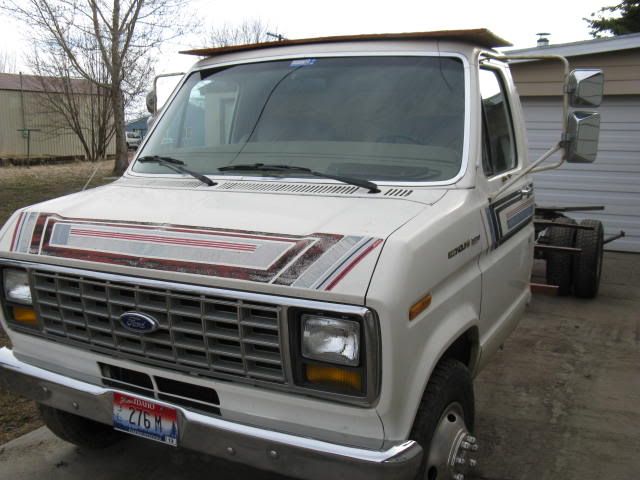

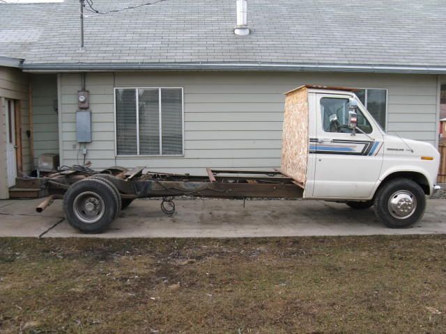

Ok...been hanging about checking all the current buildups and now am pretty much ready to tackle my project with the help of my friend (now that the snow has subsided and I was able to pull her out of the back yard). My plan is to have an overhead cabin similar to the original sans front window. I'll have two small port windows (same as will be on my boat) on the port and starboard side of the cabin and the living quarters will extend back 8'. I know this is small, but I don't plan on "living" in it for extended periods. The remaining 6' will be diamond plate flatbed for hauling atv's etc. My thoughts are that the bed will be 8' wide by 6' long which should be ample for anything I plan to haul. I'll build aluminum boxes to hang under the sides of the bed and will store equipment in these. I'm open to suggestions and ideas. I'm including some pics, so when you stop gagging and wipe the tears of laughter from your eyes...please give some input! Thanks!

All I can say is plan, plan, plan. Your biggest problem IMO will be weight creep. Don't overbuild it. Folks I know that have build large things like this are astounded as to how heavy they ended up.
BTW, while you can get to the fuel tank easily it might be worth checking on its health and maybe cleaning it out.
The up side is you can install just what you need and not the stuff you don't. If you don't want an oven you don't have to install one.
Have fun.
BTW there are RV surplus/salvage places out there where you can get parts for really cheap. Some stuff is new, just not current issue. Manufacturers sell off their surplus (very cheaply) to these folks that re-sell them.
You might list the amenities that you are planning to install and folks can offer up ideas. There is a lot of creativity out there from people that cannot leave good enough alone and start modifying their RVs.

Thanks for the reply. I have all the equipment that was in her prior to disassembly. Stove, Fridge, Furnace, Water heater, AC. My thoughts are going with a very small dinette table, shower, commode, window AC unit, smaller fridge, one sink. Debating on just utilizing a two burner camp stove in lieu of the full size range/oven.

How's your welding skills? I would make the floor from 2x3 square tubing and the walls and roof from 1x2 or 1x1 square tubing.

Better than average..just picked up a Millermatic 212 last summer and haven't gotten a chance to play with it too much. You don't think I'd accumulate too much weight going with the tubing?
