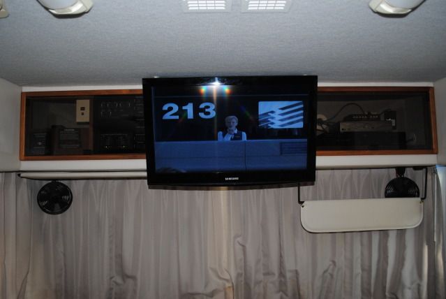

Got tired of hauling that old 80LB tv in my 2001 Expedition. Got a good deal on the Samsung 32" at 297.00. So it was time for the project.
The old tv hung down from the overhead and made a really good head knocker.
I didn't photo all the take down of the old tv, but it is really simple. If you look inside the face frame, you will see some brackets where it is screwed into the box, remove those screws. When you have removed the surround, there is a brace at the top of the tv again held in by a couple of screws, remove those.
Next you will see a couple of small braces at the left and right side of the tv at the bottom. There was a hidden screw on each of these on my tv. You can locate those by using a phillips head/cross head screw driver and feeling around. Might be able to locate them with your fingers also. Remove those screws. Then remove the little blocks the screws are holding.
Ok, now check in the right equipment bay where the tv is plugged into a special plug that prevents it from being on when underway, unplug that and work the plug back into the hole from the tv cabinet.
When you remove the tv remember a couple of things, it is very HEAVY, weighs about 80 LBS and it will still have the cable screwed to the back. Make sure you have a pair of pliers or a small cresent wrench to remove the cable. If yhou have two people the job will be much easier.
Once you have removed the TV you can see how the cabinet is attached to the overhead cabinet area. Mine had two wood screws at the top on each side and two on the bottom each side. Once these are removed the box can be removed. It is covered with ultra leather or whatever they call this stuff on each side bottom and back.
I wanted to keep the same angle and projection from the top of the cabinet so I decided to cut the bottom of each side to 16 3/4 inches. This made mine even with the bottom of the rest of the cabinet area.
If you do this you will have to make a new bottom. I used 1/2 inch plywood for the new bottom and then replaced the angle braces which were in the old box for reinforcement. I reused the foam rubber padding and the covering, took a lot of stretching and pulling to make it work but I did. I should have cut the bottom just a little under 27" to allow for the padding and the covering, so you can see from the pictures that it wrinkled a little from being a little tight.
Check your measurements. I also put a brace across the top of the box, a 2 X 2. Lastly, I used 3/4" plywood recessed back 2 1/4 " from the front edge, screwed and glued to the inside of the box. I also used cleats behind the plywood face, and the plywood was screwed to those, and along the 2x2 across the top.
I used a 2 1/2" hole saw and cut an access hole where the connections to the tv would be. I enlarged that slightly with a saber saw so I could get my hand behind it. I used a mount that I bought at wally world it is a Sanus and has the 200 x 200 MM mount arms that my Samsung required. I mounted that to the tv and then placed chalk around the mounting hole. Held the tv at the spot where I wanted it, moved the unit around a little and the chalk left a mark where the mount top hole should be drilled.
I drilled the hole for a 1/4" bolt and installed the mount with the two 1/4" bolts and nuts and lock washers. Oh yes, I made sure that both side cabinets were still accessible when the tv is mounted. Put the Tv on the mount and pushed the little tab and locked it down.
Now it looks like this.

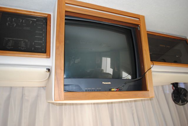

Did the same with my coach.
Before:
After:

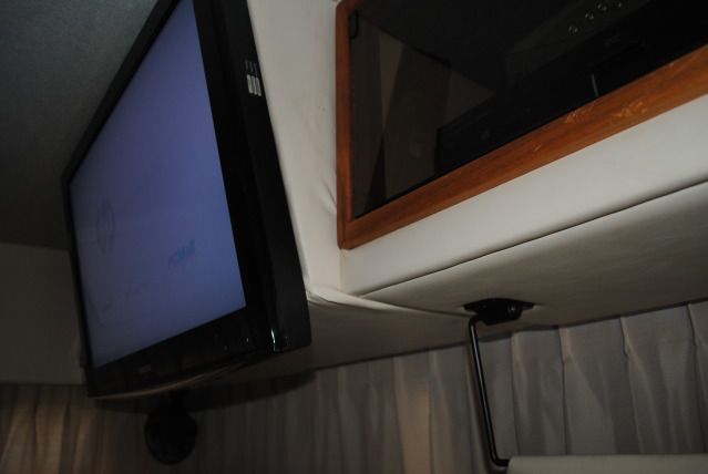

Here's mine
Jeff - WA6EQU
