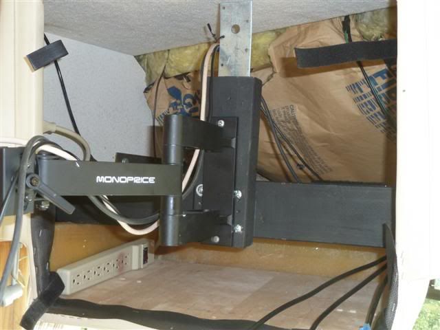

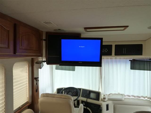

I used 2x4 framework in the old box and fastened a TV mount to the 2x4.
The mount I bought from MonoPrice.com. Total investment was about $30 and I only know how to use a saw and a screwdriver.
Finished Product:
Behind the TV:
Not over engineered but works just fine.

I fastened a light 3/4" plywood panel to the back side of the walnut hole surround.
Then I cut holes for the cords and mount arm to pass through the panel.
I did the panel in two sections, fastening the bottom section to the top section with a piano hinge.
I can now slide my DVR into the empty cabinet behind the bottom section.
Painting every thing black matched the other two panels on my overhead console.
This is the only decent picture I have of that part:
