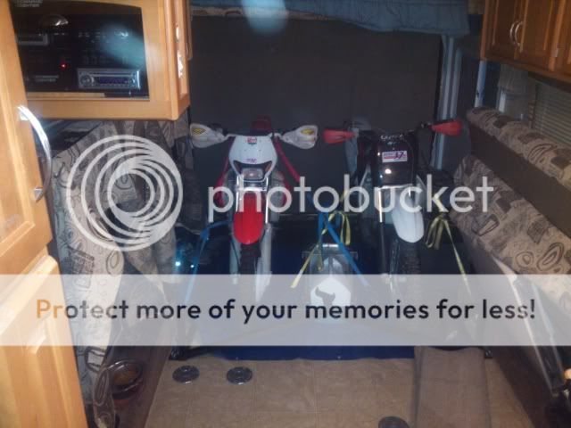

That's the same on mentioned earlier. The only issue with that design is there are only two attachment points to the floor, one at either end that attach via J hooks/knobs. Only two 3/8" bolts holding as many as five toys is quite a bit IMHO. I've got 4 attachment points on mine and two are eye bolts that I use as tie downs for the bikes so I'm not putting 100% of the stress on the rack only.
I didn't take this photo to show off the rack so it's not real clear but you get the idea. I also run a tie down from one rear corner through/around each rear tire to keep the backends from bouncing sideways.

Is that a cooler in the middle? That must be some precious cargo inside, with its own position there and all.
